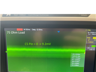

  • Sorry for the delay! I have been working with another engineer on this and we were struggling to get the stage with the LM5156 working, nevermind the LDO stage. Attached is the behavior with a 75ohm load across the ~44V output of the boost stage board with the design referenced earlier in this thread and the reference thread.

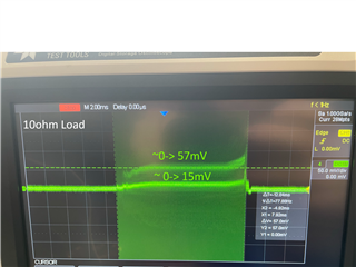

  • Below is the same operation with a 10 ohm load across the ~44V output.
    We had previously had success with this same 10ohm load, incorporating the 100uF at the output stage that your colleague had recommended. In this case, we started with a fresh board and then changed the output capacitance. Nothing else has changed that we are aware of.

  • Hi marsh,
    Can you please reattach all relevant files?It is not easy to search through all the threads and posts over the time.
    The schematic would be important.
    In the first scopeshot all seems to be good, right?
    The current sense signal should be measured zoomed in do that single cycles are visible. Here, i can only see noise. Also it is important to use a very short ground connection.
    In the second scopeshot it is starting up but then shuts down. What happens later? Does it try to start up again?
    For the CS signal, please refer to above.
