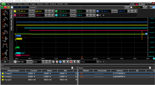

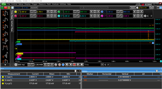

After our product has been turned on and placed for two days, it enters a shutdown state, and the battery discharges to below 2.85V, making it impossible to charge with the charger. When the USB is inserted, there is a normal charging state of 1-2 seconds where VPH rises from 2.8V to 3.65V. The machine attempts to turn on for 2-23 seconds, and the battery has a current output of 0-300mA. VPH drops to 2.8V, and the charging state is unclear. The SW has a switch signal, but the frequency is only 1.3K. After 23.15S, the battery's output current suddenly jumps to 0mA, and it remains at 0-2mA output for the rest of the time. If the USB is unplugged and plugged in at this time, the battery still remains at 0-2mA output. If the battery is disconnected from the motherboard and reconnected, the above process will repeat, with 1-2 seconds of charging, 2-23s of unclear charging state, and 0-2mAs output for the rest of time. When the battery voltage is ≥ 3.0V, the charger will repeat the above 0-23s action, and start charging at 24s with VPH rising to 3.6V.
    Can you please send a schematic and a register dump when this is happening? Does the battery have a protector?

    0 1 2 3 4 5 6 7 8 9 a b c d e f 0123456789abcdef
    00: 04 1a 86 10 98 8f 65 4c 34 03 80 01 ff ff ff ff ??????eL4???????
    10: ff ff ff ff ff ff ff ff ff ff ff ff ff ff ff ff ??????????????

    Have you tried an ABA swap? This is where you take the bad unit and put it on a good board, and a good unit and put it on a bad board. This could provide valuable information.
    I noticed that the PG pin is tied with 0 Ohm to CBL_PWR_N. Is there a 10k pullup? I think the device could be damaged by shorting the pull up rail to the open drain of PG/. Please insert the 10k pullup and let me know the result.
    Mike Emanuel
    Every board have this problem. There is no 10K pullup tied to PG. I will insert the 10K pullup.
