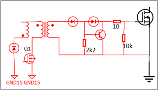

I realized an evaluation board like the one in the figure to generate a stable 250v starting from an unregulated 50 volt. The 15Vdc is isolated from others two and it supplies the IC.
So the features are: 30-70Vin --> 250Vout --> Pout=70W.
The problem is the following:
- when in sequence I turn on the 50 volt and then the 15 volt the converter works correctly even if I struggle to make it stable for the entire input range of the 50V.
- when I turn on the 15 volt first, pin 7 (OUT) goes to 1, saturating the power mosfet driving transformer and causing the failure of the gate transformer driving mosfet.
How can i solve this problem? Have I chosen the right IC for my requirements?
Let me know.
  • If 50V is not biased first, there won't be any current on Q2 when you turn on the 15V rail, so no output and the IC is continue to demand current and consequently saturates the gate driver transformer.
    So there is no way to turn on the 15V first?

    How did you connect the gate driver transformer? One end to the Q2 gate. What about another end?
    It is arranged as forward converter in this way where the Q1 mosfet gate is connected to LM5023 OUT Pin.
  • LM5020-2 has max 50% duty cycle limit. This can prevent the transformer from saturation.
