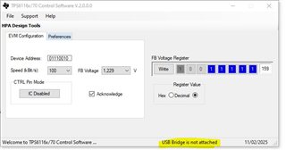

The EVM is working correctly without control board but when I connect the control software i have this problem :

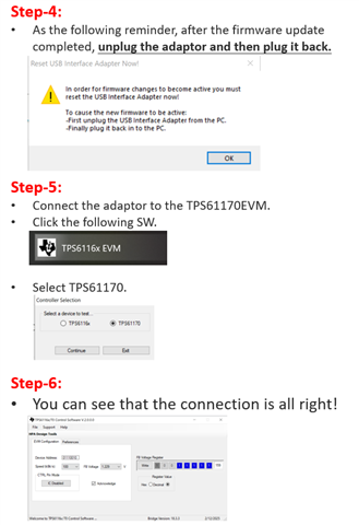

    I tried the connection just now. All the SW and HW are new. Which means, the SW was also downloaded and installed just now. The adaptor and EVM were new. Finally the connection was successful.
    My OS on PC is Windows 10 Professional.
    I just summarized the following 6 steps I did minutes ago. Please try again.
    Lei

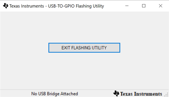

    - Launch the Rirmare Flashing Utility and the result is this:
    On your adapter witch version is loaded after the update ?

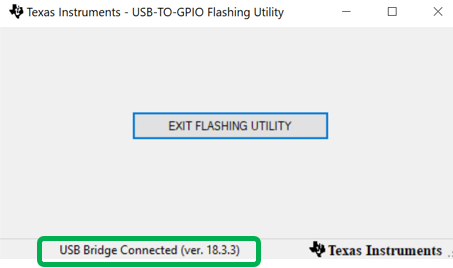

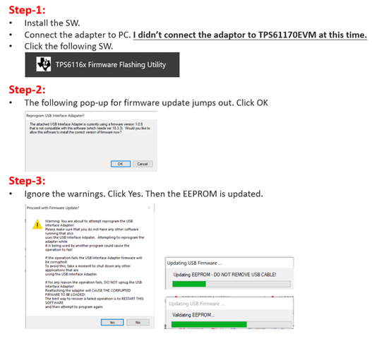

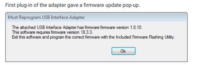

  • Hi Stefano,
    Before firmware update, the rev is 1.0.9. After update, it's 18.3.3.
    Here are more information for your reference:
    The following pop-up means your adaptor is not connected to your PC successfully.
    If I didn't connect the adaptor to my PC and click below, I'll see the same pop-up.
    Following is the successful information.

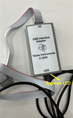

    Here is the adaptor I used.
    I think the root cause is that your PC can't recognize the USB input. I just tried on my colleague's PC, after plug-in the USB, without any special steps such as install a driver, the PC can recognize the USB input.
    Could you try on another PC if available?
    Lei

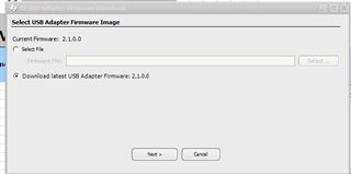

  • UPDATE ANSWER:
    If you say that the problem is the USB2GPIO firmware is is possible intall a correct FW by using Fusion USB Afapter Firmare Image ?
    This is the relative GUI:
    Thank You

  • Hi Stefano,
    During my connection handling I don't use or see the GUI you showed.
    Sorry I don't have a newer adaptor at hands. I will apply for a new one and then try. It takes time for this new adaptor.
    I suggest that you may open a new thread with part number USB-TO-GPIO2. With so the experts for this adaptor may give more helpful suggestions.

  • Hi Stefano,
    Sorry for a late and "bad" update:
    I just received a new applied TPS61170 EVM which contained adaptor 2022. Unfortunately, the adaptor can't be connected to the EVM neither at my side now. I think it's caused by that the old software is not compatible with the new adaptor.
    So my suggestions are still the same as before, for example, you may use a MCU IO to configure the specific pattern on the CTRL pin and program the TPS61170.
    Lei
