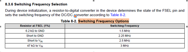

3.  In addition, there is a problem, the switching frequency of the following TPS62876-Q1 datasheet can be configured through hardware, please confirm whether the circuit needs to be adjusted if we need to change the frequency in the subsequent debugging process? Is it stable after frequency change? Do I need to do additional tests?

  • Hello Gao,
    I will provide a review of the schematics and layout later this week,
    Regarding question 3: I do not fully understand. What frequency is your application targeting? What do you mean with changing frequency?
    The frequency setting by external resistors is read during startup only.
    Regards, Werner

    Regarding Q3:
    If the customer wants to change the frequency, it is possible the compensation values and Vout need to be adjusted, depending on the load transient requirements. The datasheet, section 10.2.2, shows that the calculation is depending on fsw.

    Compensation is depending on the switching frequency and Cout. This is important for applications with high load transient requirements. This application usually has more relaxed transients, so I assume that the frequency can be changed easily. The system stability should be tested after changing frequency to determine if different COMP pin configurations are needed.
