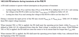

    2. Using I=Cdv/dt with I=25.5W/42.5V=0.6A, dv=42.5-36=6.5V and dt=250usec results in C=~23.1uF.
    Power Bulk Cap
    13W 10-22uF
    25W 33-47uF
    50W 68-100uF
    70W 100uF-200uF
    25.5W 推薦33-47 uF. 22uF 比較worst的250us 0-current transient不行,但99.9%的情况影響不大。
    3. If the PD cannot pass the handshake, can you double check all caps between VDD-VSS is less than 120nF? And could you share the waveforms including the PD's VDD-VSS voltage and current in power interface?
    If the PD is connected then power off, it may be related to the loss of maintain power signature. Could you try with a load > 1W?
    Diang

  • Hi Shermen,
    The 22uF C22 is the VC cap. It is related to the PWM control IC and start up delay time. 22uF electrolytic cap normally is enough for a proper inrush delay time. A ceramic cap may have DC bias which could has effective lower cap when voltage is high.
    The 47uF C11 is the cap we did the calculation about the 250 us transient time. It normally need electrolytic cap too.
    Diang

  • Hi Shermen,
    Thanks for your patience.
    For C11 = 47uF or 22uF
    From FAE/ Ian and you said that "25.5W 推薦33-47 uF. 22uF 比較worst的250us 0-current transient不行,但99.9%的情况影響不大。"
    Yes this is for the C11: 33-47uF is recommended to fully compliant with standard. But 22uF in most of cases can be fine.
    For C22 = 22uF
    PD needs to have a >80ms inrush delay. It is mainly the total timing of inrush timing delay + DC/DC soft startup delay. 22uF is for adjusting the inrush timing delay, which is 44ms - 158ms (22uF is Electrolytic cap in the test). If your DC/DC soft startup delay is long and the startup current is less than 0.4A, you can use smaller C22.
