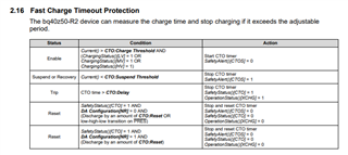

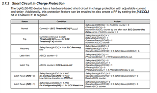

When there is huge throttle variations like 60% to 0% the bq enables the ASCCL, SS and CTOS register, why and how to make sure that doesn't happen.

    For the ASCCL and CTOS, these are protections being tripped by the current. You will need to change their thresholds:
    SS just reflects that there is a Safety Status Event occurring from the protections above.

    There are 3 MOSFET's. The MOSFET functioning are not clear when the CHG MOSFET is "OFF" and only DSG is "ON", it heats up the same way.
    When both CHG and DSG MOSFET's are "ON" it doesn't heat up, unless such variations in throttle (current draw) happens, then the CHg turns "OFF" then it heats up.
    Is this the normal condition ?
    We need only DSG MOSFET to be "ON" and CHG MOSFET to be "OFF" in the next use cases. As of now this condition is not working due to extreme heating.
    Is there something that is causing the CHG FET to turn off in this situation? If the current being seen is greater than the DSG Current Threshold, this will make both the CHG FET and DSG FET active to protect the bypass of the CHG FET.
    Anthony
    The sudden change in current draw is being taken as Short circuit in the bq, this causes the CHG MOSFET to turn off.
    What is the voltage being produced at the CHG pin once the short circuit has occurred and discharge begins to take place again? Once the gauge enters discharge mode from the DSG Current Threshold being cleared, this should allow for the CHG FET to close again during this time.
