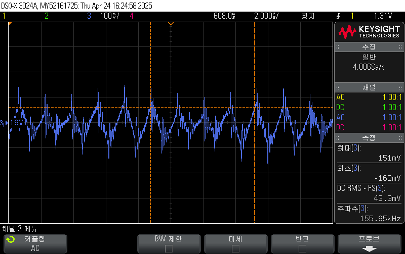

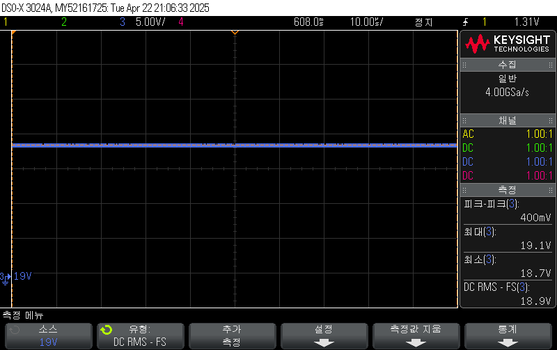

    [250422-LP]  There is no noise when there is no load, but even a light load causes audible noise.
    Can you check the output voltage ripple and the inductor current and share with me?
    [250422-LP]
    Please refer to real measuremnet result related to output voltage ripple.
    Does 'inductor current' refer to the actual measured current? I'm currently using the inductor recommended by TI.
    The DC/DC converter is connected to the main power input of the DLPA3005. The LED current is in the range of 1 to 10 A.
    Power supply: 24V / 3.5A → DC/DC: 19V → DLPA3005 input: 19V → DLPC LED Setting : 10A.
    Can I solve the audible noise after chaing switcing frequency?
    Best Regards
    LP KIM

  • Hi LP,
    Few comments/ requests:
    1. I checked the inductor waveform - based on what you have shared - the time difference between two swithcing instances is ~15us - which leads to a frequency of ~67kHz which is well outside the audible range.
    2. Are you sure it is the inductor causing the noise? Ceramic caps can also cause audible noise because of their piezoelectric effect. (See https://www.murata.com/en-sg/support/faqs/capacitor/ceramiccapacitor/char/0020). Please confirm.
    3. Can you change the mode to FPWM and check if this solves the issue?
    Taru
    [250424- KES] I known that the switching frequecy measured aging . it was about 400[kz]. As you mentioned , it was outside the audible range.
                            I think that the root cause isn't not inductor with 400KHz frequency. What do you think?
    2. I will check.
    3. Impossible.

  • I known that the switching frequecy measured aging . it was about 400[kz]. As you mentioned , it was outside the audible range.
    I am not sure what you mean by this. But yes, as I said - inductor doesn't seem to be the problem based on what I can see.
    Can you also check if the inductor is mounted and soldered firmly on the board?
    2. I will check.
    I shall wait for your response.
    3. Impossible.
    I am not asking you to change the design permanently - this is just to troubleshoot.
