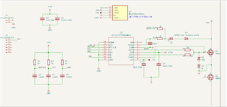

  • Hi Sasi,
    I have designed a Gate driver using UCC21750.Here I am attaching the design. Please review and tell is it ok or not if any suggestions please let me know.
    I have following doubts with the design please clairfy:
    1. I came to know about the 2 decoupling capacitors 1 for the high frequency noise rejection with low capacitance and for good voltage stability high capacitance is needed. With single capacitor it may not possible to have above two functions. I know abt the thumb rule like for small caps 100nF-1nF and for large caps >1uF.  I want to know How to calculate of these Decoupling capacitors?
    2. is it necessary to keep a Input and output RC filter and reason? How to calculate the RC values for filter for operating frequency of 20KHz in detail?
    3.How to calculate the Pull up resistors? here I have used pull up resistors for RDY, FLT, REST pins as per specified values in datasheet 5Kohm and a filter capacitor of 100PF. How to calculate the Pullup resistor and filter capacitor 100pF?
    4. Regarding DESAT I came to know that DESAT threshold can be set by using Zener diode. I dont understand this one exactly how it works. Please Explain?
    5. Please explain How to calculate the DESAT circuit components Cblnk, Rlim.
    If possible can i connect through mail for better understanding of concept.
    Thanks for your time.
    Sravan Kumar
  • Hi Sravan,
    Sasi is out of office and I can help with these questions.
    For simulation, I suggest:
    • Tying AIN to COM and leaving APWM floating if not used
    • Use the calculator tool Sasi provided to calculate the DESAT detection threshold. Looks like you have a 7V zener in the path, maybe that will make the DESAT detection threshold too low
    • In actual design, VDD-COM capacitors are needed to keep VDD stable
    To answer your questions:
    1. Yes, we usually suggest one capacitor in the order of ~100nF and another in the uF range. System noise can range from a few MHz to hundreds of MHz, and having small decoupling cap, together with the parasitic resistance on the board, can help us filter out the system noise well.
    2. I would recommend input RC filters, resistance ~100Ohm and capacitance in the tens of pF range. Again to filter out system noise.
    3. 5kOhm - 10kOhm pull up resistors are sufficient. The RDY and nFLT pins are open drain outputs, and this resistor helps limit the current into nFLT/RDY when it's pulled low.
    4. You can refer to this E2E: https://e2e.ti.com/support/power-management-group/power-management/f/power-management-forum/1011100/faq-ucc21750-how-can-we-adjust-the-desat-detection-threshold-in-ucc217xx-iso5x5x
    5. Recommend Rlim in the 1kOhm-10kOhm range. You can choose a Cblk value that best matches the DESAT timing you need. It's usually in the tens of pF to hundreds of pF range, please refer to the calculator tool Sasi provided.
    Thanks,.
    Vivian
    Thanks for your reply. I want to know How to calculate Pull up/down resistor values, decoupling capacitor and RC filter values with suitable equations.
    2. The above attached design is ok for Hardware if not please rectify errors. is it possible to do simulation for this design!
    Thank you,
    Sravan Kumar.
  • Hi Sravan,
    Cutoff frequency for noise is just 1/(2*pi*R*C). If you have a system noise frequency in mind you can use this equation.
    Pull-up resistors are used to limit current into the pins. Current into the pins can be calculated by VCC/R where R is the resistor size.
    You can try using PSpice for TI to run the sims.
    Vivian
