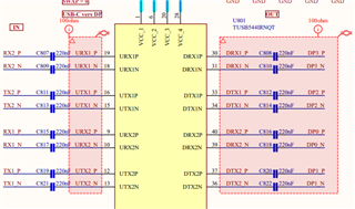

  • Hi Brian,
    Thank you for your quick reply.
    Yes, we using a DisplayPort receptacle on the output side of our board.
    We wasn’t aware that the TUSB544 is primarily intended for USB-C to USB-C applications.
    We based our design on the TIDA-01620 reference design, which uses the TUSB544 between a USB-C connector and a DP connector.
    Please find attached the schematics of the USB-C connector, the TUSB544, and the DP connector.
    Regarding the TUSB544 schematic, it is intentional that RX2 is connected to URX1, TX2 to UTX1, etc.. We made these choices to optimize PCB routing, and we’re using bit 2 (FLIPSEL) of the GENERAL_4 register to reorder the signals correctly via I²C.
    Let me know if you need any additional information about our design.
    I’ll continue running tests on my side and will update you if I manage to identify the cause of the issue.
    Thanks again for your support.
    Clément Perrin
    5047.USB-C_CONNECTOR_SCHEMATIC.pdf
    3755.TUSB544_SCHEMATIC.pdf
    3755.DP_CONNECTOR_SCHEMATIC.pdf

  • Hi Clément:
    your schematic didn't match the channel mapping in datasheet.
    Best
    Brian
  • Hi Brian,
    Thank you for your quick response and for reviewing the schematic.
    You're right — the lane mapping does not fully follow the datasheet. Here's how I understood the behavior of the TUSB544, and I would appreciate your clarification on any misunderstanding :
    • Since the PC provides the DisplayPort signal, I assumed the DP lanes enter through the upstream port of the TUSB544. I configured the chip in USB + DP Alt Mode (Source), with 4 lanes enabled.
    • To simplify routing, I connected the signals as follows:
      RX1 → URX2 → DRX2 → DP0
      TX1 → UTX2 → DTX2 → DP1
      TX2 → UTX1 → DTX1 → DP2
      RX2 → URX1 → DRX1 → DP3
    I thought there was no distinction between URX and UTX, so I did not strictly pair RX1 to URX1, TX1 to UTX1 etc...
    • This routing aligns with a pin assignment C or E in Flip mode, so I enabled the FLIPSEL bit.
    • Since USB-C cable is in No Flip for my tests, I forced AUXP to SBU1 and AUXN to SBU2 using the AUX_SBU_OVR bit.
    • Your review made me realize that my configuration, using a USB-C to USB-C cable between two receptacles, is more compatible with DP Sink mode.
    • I wasn’t aware that USB-C cables cross TX and RX (TX <--> RX).
    • I initially based my design on the TIDA-01620, but that uses a direct USB-C plug, not a cable between receptacles.
    So, taking the example of the USB + DP Sink No Flip configuration, we should have the following lane mapping:
    TX1 → URX2 → DRX2 → DP3
    RX1 → UTX2 → DTX2 → DP2
    RX2 → UTX1 → DTX1 → DP1
    TX2 → URX1 → DRX1 → DP0
    Considering the internal TX/RX crossing, my current routing actually results in:
    TX1 → URX2 → DRX2 → DP2
    RX1 → UTX2 → DTX2 → DP3
    RX2 → UTX1 → DTX1 → DP0
    TX2 → URX1 → DRX1 → DP1
    Indeed the lanes are reversed, this might explain the brief image flashes we observe.
    However, even when testing with only 2 lanes active (either DP0/DP1 or DP2/DP3), I still don’t get a stable image, and I can’t explain why.
    I now have three questions:
    1. Can you confirm that a USB-C to USB-C cable crosses TX and RX?
    2. What is the difference between DP Sink mode and DP Source mode in the TUSB544?
      From what I can see, the only change seems to be the positioning of the lanes ML0, ML1, ML2, and ML3 between the URX/UTX and DRX/DTX ports.
      Is there any other functional difference? Because it seems that with the right SWAP configuration, one can switch from Source to Sink mode just by reassigning the channels.
    3. Are there any aspects of how the TUSB544 works that I may have misunderstood?
      If there are specific details or configuration principles I’ve overlooked, I would really appreciate your clarification.
    Thank you again for your help.
    Clément
  • Did you use USBC cable on left (UTX/UTX0) and DP cable on right side (DTX/DRX), if yes, then TUSB544 should be configured as Sink application.
    Best
    Brian
  • Hello Brian,
    Thank you for your support — my board is now working perfectly.
    Indeed, I’m using a USB-C cable on the left side (UTX/URX) and a DisplayPort cable on the right side (DTX/DRX).
    I reconfigured the TUSB544 in DP Sink mode, which makes more sense for my use case. I based the configuration on Pin Assignment E in UFP_D mode for DP Alt Mode, and I also took into account that in a USB-C to USB-C cable, RX and TX lines are crossed.
    I also applied some equalization adjustments:
    • Upstream DC Gain: 0 dB
    • Downstream DC Gain: 0 dB
    • VOD Linear Range: 1100 mVpp
    • Upstream EQ Gain: 2.7 dB
    • Downstream EQ Gain: 2.9 dB
    Initially, I was testing with a display that required 4 DisplayPort lanes. Since the lane mapping was incorrect at that point, it explained the image “flashes” I was observing.
    Thanks to a multiplexer (used in the second part of my design), combined with various TUSB544 configuration options (notably the FLIPSEL bit), I was able to use only 2 correctly mapped lanes, allowing me to drive the 2 lanes DP Display used in my design.
    Thank you again for your time and support.
