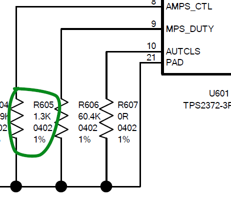

    1. To enable the auto maintain power signature, AMPS_CTL needs a 1/4W or larger power rating at R605. Normally 1206 or larger.
    To disable the auto maintain power signature, you need to DNP R605.

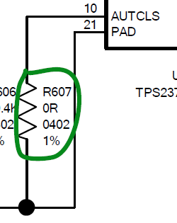

    2. In most of cases, autoclass function is not needed, unless the application is constant load like LED lighting. DNP R607 to disable autoclass function.

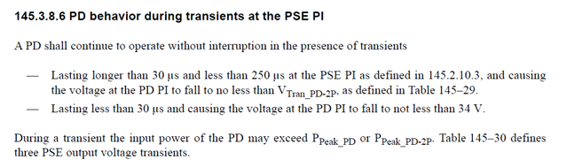

    4. PC601 is optional to use 33uF to meet PoE longest 250us 802.3BT transient requirement.

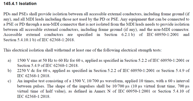

    5. Isolated DC/DC is optional to meet 802.3BT standard isolation requirement.
