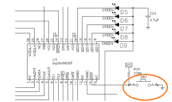

    1. The LEDs will light when the DISP input is held low. You should be able to keep it low and provide a continuous display. This will draw more current from the batteries.

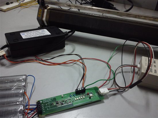

    I connected a battery pack, charger of 13.5V and a load in the concerned places. But Q2,Q3 and Q4 are heating up so much, that i could no longer continue the config(image attached).
    1. Why is it happening?How to solve/ continue my work?
    2. I realised that the cell pack is getting charged(initially was 6V, with in seconds it became 10V, but Mosfets were dam hot), But I am usinga charger with out anyher protection circuitry on my cell pack other than the HPA435. First level and second level protection of BQ29330 is sufficient to protect my pack or do I really need an extra protection circuit
    ( I am using a charger)
    3. Or could you suggest me the best suitable charger and load for the testing , if any ?

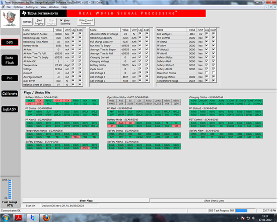

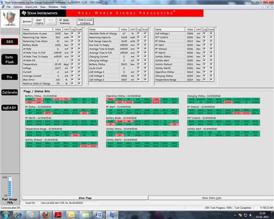

  • Tom, I tried writing the flag reset (see figure ) but still getting the ld message that flag  should be reset.WHY?
  • Nikhila, I would check the cell voltages to make sure that one of them is not damaged. The charger also has to be able to provide adequate voltage and current to charge the pack. You may want to start with a good power supply until everyting gets setup properly. If the cell voltages are different, then you may want to pre-charge them to make it easier for the system to start working. Could you sed me a .gg file and .log file to hel analyze the problem? Thanks Tom
  • Nikhila, The screen shot shows that you have a SUV fault. The command cannot clear the fault, if a valid fault is present. You may have to disable the fault until the system gets setup properly. You can do this by setting the timer for the fault to 0. Regards Tom

    1. Even if I press the switch for a long time the display leds are not bright/ON. In that case if i grounding the DISP\ pin, will it work?

  • Earlier post was not showing this image:-( (this is the reg. where i tried to change the flag ,but not reflecting/ allowing)
  • Nikhila,
    I am fairly new to using this device, so I will need to try to recreate your experiments. The documentation says that the DISP is H-to-L triggered, so maybe it only stays on momentarily. I will have to confirm whether the LEDs can be held on continuously.
    Faults can be disabled by setting the respective timer values to 0 on the Data Flash screens.

    how to reset SOV flag?
  • Nikhila,
    I reviewed your .log and .gg files and do not see any entries that would cause the device not to operate. The SOV flag is set in the .log files from the beginning, so it does not offer any insight as to when the fault occurred. You can disable the SOV fault from reporting by setting the SOV time to "0". (see the attached file) You may have to send the PF clear command mentioned in a previous post to clear the fault after setting the SOV time to "0".

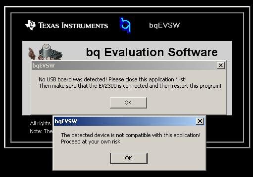

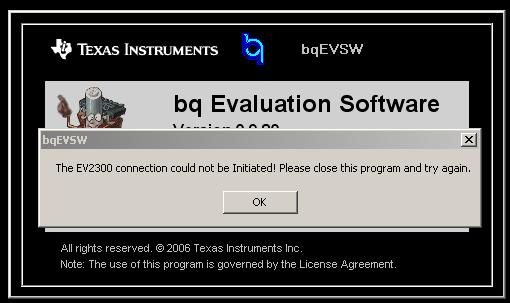

  • Tom, I tried Uninstalling the software and reinstalling it, as the older software is not functioning.
    1. Each time after II remove EV2300 hardware from the USB port, I am forced to install the driver software again and again.(Otherwise it is not recognizing.  I triedw with both 32 and 64bit Win7)
    2. When I tried installing the bqeasy, "software is corrupted/ didnn't down load fully " msg is coming.
    3. When I tried with the old file, "device is not compatible, proceed at your own risk" msg is coming.
    4. Many times I noticed , with out charger connected to the slot, gas gauge indication is not 'ON' (even if the hardware is connected to the system). how to solve this?
  • How to solve these ??
    Nikhila,
    I have run into two issues when trying to setup comunications.
    The first one indicates that communications with the EV2300 cannot be established. If you get this one, then you may have to go to the Windows System screen and delete the EV2300 and re-install it.
    If you do not get the first one and get this warning, then this indicates that the EV2300 is working properly and BQEVSW does not recognize your EVM. The device could be damage or the the firmware could be corrupted. You can try reloading the firmware. I attached an applications report. I will attach the .senc file in the next message.
    Tom

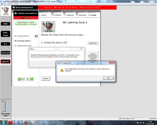

    First cycling takes less than a minute but second one almost 2 hrs. Before I finish the second cycle , it is getting cancelled.
    Whta i did is ,I just connected the charger and a load to the module plus the cell and put it in the cycling.
    Am I correct???

  • Nikhila,
    Some people have problems using bqEasy to run the learning process on a pack. The manual method will probably work better. Are you still using our EVM for the evaluation? The golden file (used to program other devices) should be created on your module, becuase this will allow the device to compensate for the PCB, battery connections, etc. You can create the golden file using our EVM, but the final setup may not be as accurate.
    You can pull a couple of documents from the TI website to help with the learning process. SLUA597, SLUA355B
    The communications problems that you noted may be due to bqEVSW trying to execute a command while scanning is active.

    Please let me know why PF status reg. (which contains the cycle info) scanning is in grey(not scanning). -image attached in my last mail.

    I answered the grey box question in the previous response. The grey box could be a communications problem where the program is trying to read communicate while scanning is enabled. It is better to disable scanning while accessing registers.

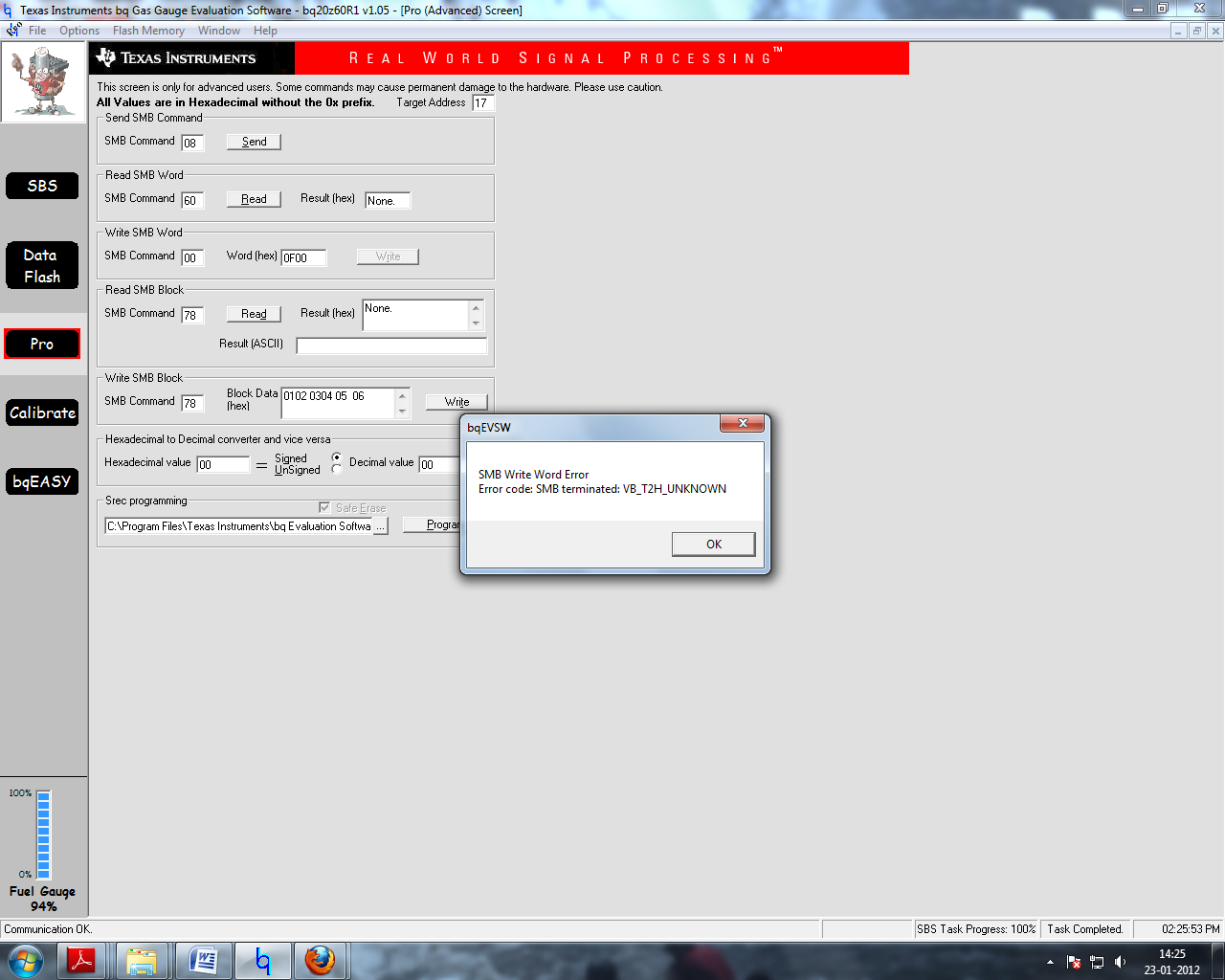

  • "You can press the SMB Command 08 button at the top of the list to exit ROM mode and communications should be restored"
    I always do that. But this time its not working,instead showing an error message.
    How to come out of this?
  • Your screen shot shows that communication is okay at the bottom left corner. You can try reading SMB 0D to see if it is in ROM mode. The returned value should be less than 64H (100%) if it is in active mode. You can check VCC to verify that it is 2.5V, indicating that the device is working. The only other thing that I would have you try is to reboot the computer and reconnect everything. I have had EV2300 problems that caused communications problems before. Otherwise, you can send the EVM and batteries to me and I will try to repair it and create your files.
  • Tom,
    Now it always shows communication error. 0D value is 0301.
    sending the unit along with battery would be difficult(EXPLOSIVE )
  • Nikhila, The 0301 data means that the device is in ROM mode. Please try reloading the .senc file and then the command to take the device out of ROM mode. If this does not work, then you may have to use a new EVM. Regards Tom

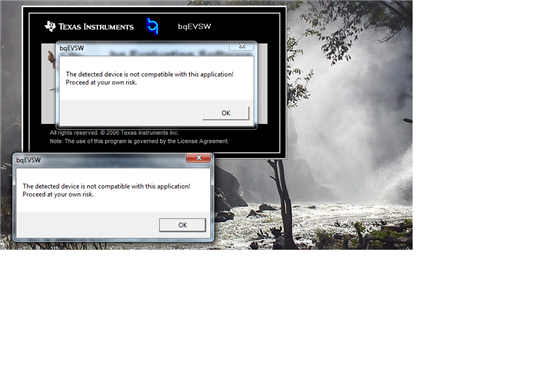

  • When I run BQESW  " not compatible " message is coming....VCC is 2.4V.
    Still,do you think its the problem of EVM?
  • Nikhila,
    It is normal to get that message after you load a senc file. We send it so that you will reinitialize the bqEVSW to make sure that you are running the proper version. Otherwise, you may not access the proper register locations. The bqEVSW should recognize the EVM and start back up without the error message. VCC should be close to 2.5V. Maybe we should have a conference call and WebEx session, so that I can look at a few things on your setup. Please enter your contact information in your biography and I will contact you outside of the forum.
