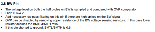

4. In the calculator tool, the BW pin voltage is derived from the bias turns, but in the PMP40766 schematic it is implemented using only resistors and capacitors. What is the difference between these two approaches?
