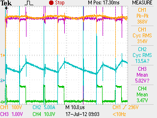

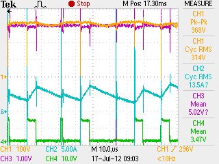

  • Hello again!
    I've just been able to reach 2.2kW. I tried to see how long it could operate but it didn't last a minute before the mosfets exploded again. I discovered that the diodes failed. If you remember i used 4 RURP8100 in parallel for the boost diode (i didnt know that using diodes in parallel was not a good idea). The peak inductor current reaches almost 15A at maximum load. So now I replaced the 4 diodes with just one RHRP1560. The previous diodes could hold 8A each, whereas this new diode could go as far as 15A. I'm planning to test the new setup just until 13A peak at the inductor. At least until the new 30A diode i ordered arrives.
    But anyway, what's bothering me right now is the noise that the PFC produces at about 1.2kW. It's like a crackle, aside from the 120Hz buzz. Is that normal?...
    Also, i see this behavior in the inductor current (blue line):
    It happens at the "shoulders", the place where the line current slope starts to decrease as it reaches the peak. Is the IC supposed to behave like that at those points? At other points, the gate voltage pulse is more or less smooth or at least a pattern is evident. Thanks!
  • Danel,
    It looks like you are hitting your current limit and that is resulting in the problem you are seeing. Try reducing the current sense resistor by 50% and see if the performance improves.
    Once you have any other issues solved then you can go back and fine tune the the current limit point.
    John

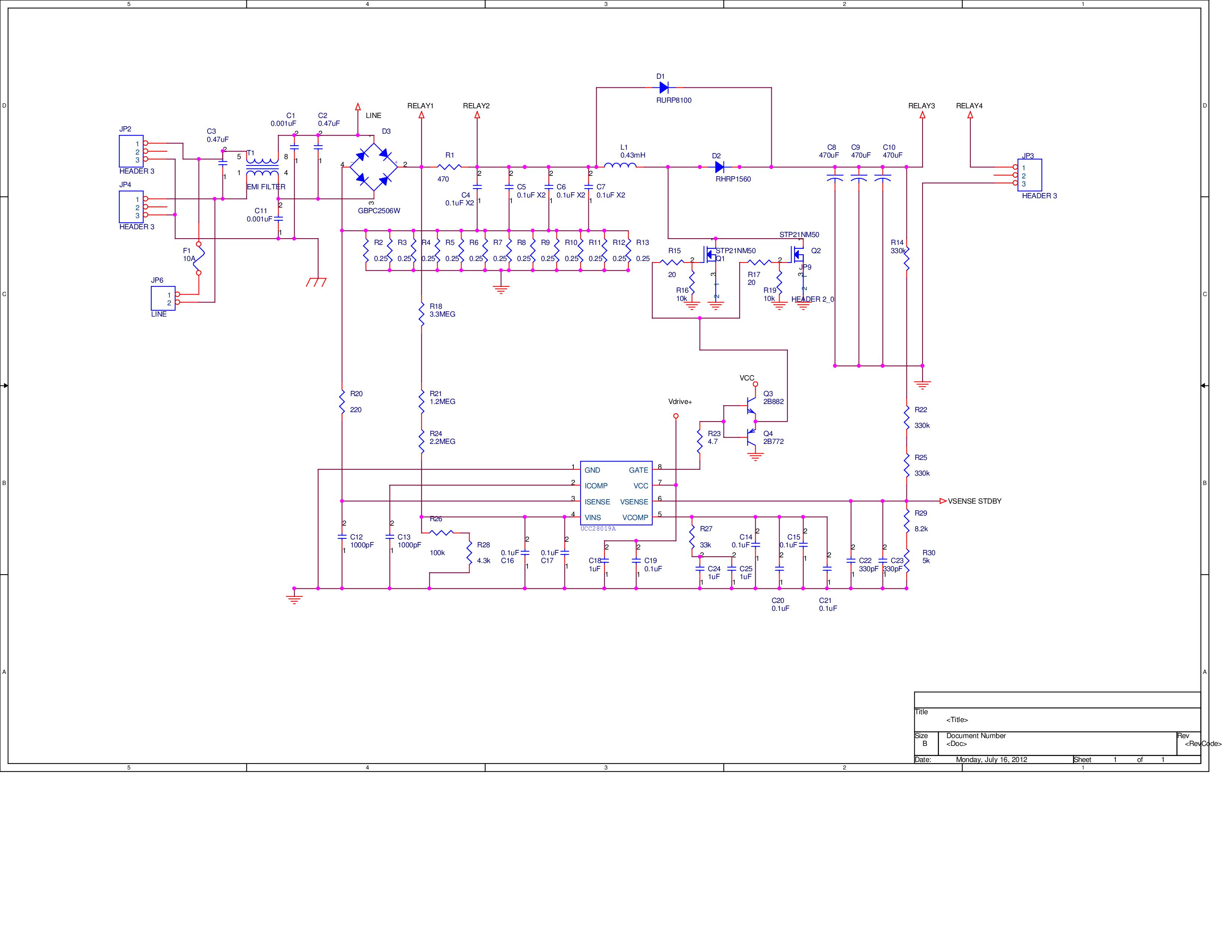

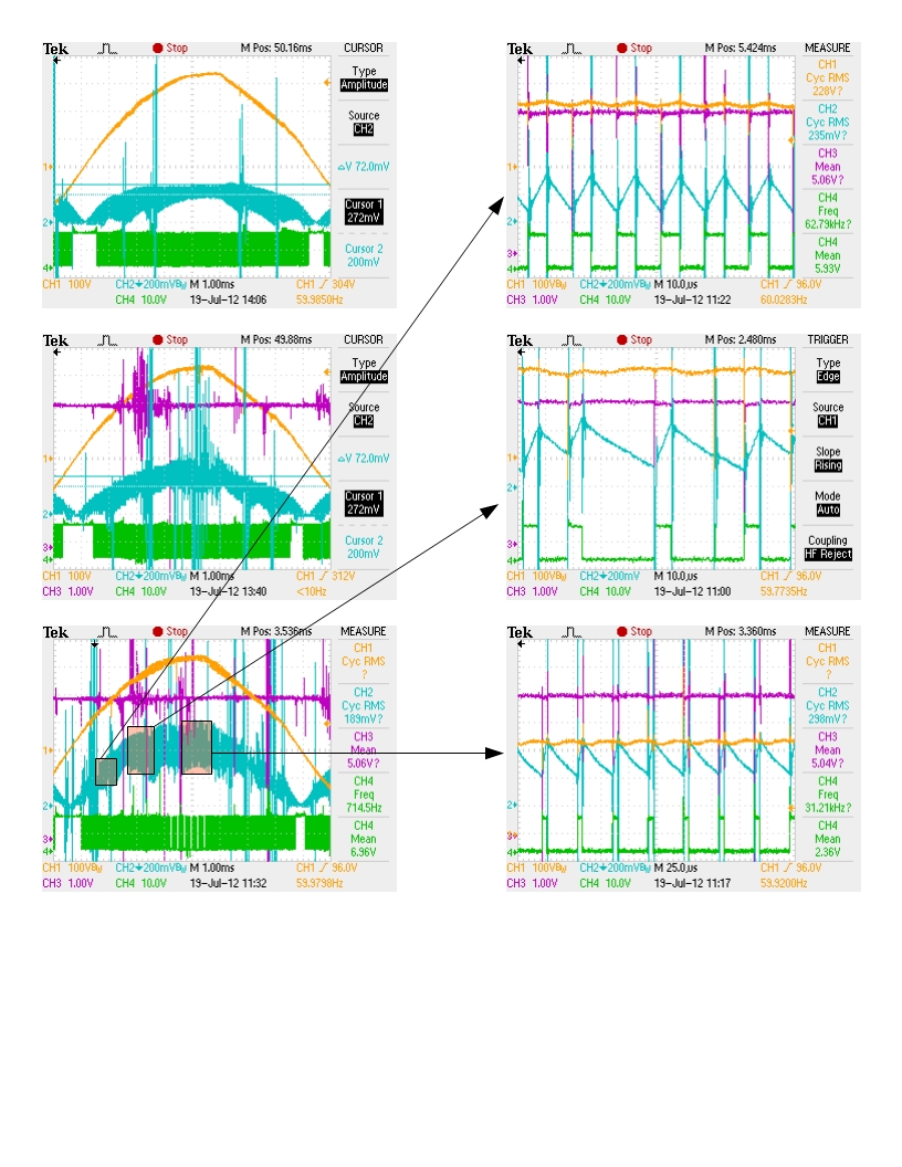

  • Ok, so this is what happens. The column on the left is the zoomed out waveforms of the Isense pin (pin 3, light blue, inverted) with respect to pin 1 (GND), gate pulse (pin 8, green), and Vsense (pin 6, purple). The top is for 600W, middle is 750W, and bottom is 900W. As you can see from the 750W, the middle part of the Isense waveform is starting to become a little distorted compared to the rest of the waveform. If you zoom in on that, you will see intermittent pulse skipping in the gate pulse. Now, when I get to 900W, the distortion becomes wider. I've zoomed in on particular points in the Isense waveform, as indicated by the arrows. At the beginning of the waveform, it's regular, with the gate pulse frequency at around 63kHz. Then when it gets near the top, some intermittent pulse skipping occurs as shown. At the peak of the waveform, I was surprised to discover that the gate pulse frequency has been halved! It's now around 31.21kHz. It means that the IC skips every other pulse. I don't know why it's happening. I'm posting the schematic after this post, but you will see there that I placed twelve 0.33ohm resistors in parallel to reach the recommended Rsense value which is around 0.025. But right now, the number of 0.33ohm resistors is 10. That means an Rsense value of 0.033ohms, making the peak current limit 1.08/0.033 = 32.73. What's confusing is that the isense doesn't even reach 1.08 and yet some pulses are being cancelled...
  • This is my schematic:
    Again, my specs are:
    Output power: 2200W
    Output voltage: 385V
  • Danel,
    The reported power levels and the power levels from the waveforms do not agree. Looking at the top left waveform the peak of the current sense voltage is approximately 240 mV. The next one down is about 272 mV and the lowest is about 300 mV. The current sense resistor from the schematic is (0.25 ohms/12 resistors).
    Taking the RMS value of these voltages and dividing that by the effective resistance we get 8.1 amps RMS, 9.2 amps RMS and 10.2 amps RMS. Multiplying these currents by the RMS value of the input voltage (340 V peak = 230 V RMS) we get power levels of 1.87 kW, 2.12 kW, and 2.34 kW. Or 3.1, 2.8, 2.6 respectively times the reported levels.
    In the words in the test the 0.25 ohm resistors are 0.33 ohms. which gives an effective resistance of 0.028 ohms and results in a power level of 2.36, 2.145, and 1.97 times the level he is reporting. He should correct his schematic before sending it out for analysis in the future.
    If either value for the Rsense resistor is correct then he is definitely going into normal current limit. This isn't a problem except there is a discrepancy between what the customer thinks he is doing and what the scope says he is doing.  That should be resolved. Does he actually have all 12 current sense resistors properly connected?
    In the high power waveform the controller is in fct skipping pulses.  This is caused by the icomp going above 7 volts and not coming down in time for the next pulse so the next pulse is missed (correct behavior). This is caused by subharmonic oscillation on the ICOMP signal resulting from the overcurrent condition resulting from the overly large ripple current compared to the average. His PFC inductor should be bigger. To overcome this he may have to increase the ICOMP capacitor.
    Remove the probes from Vsense and Gate. You can tell when the gate is high by monitoring the current.
    Connect these probes to Vcomp and ICOMP. I expect that ICOMP will have significant ripple and be exceeding 7 volts because of it.
    Things he can try after he resolves the difference in the power levels discussed above.
    Do these separately:
     1st try doubling the cap in ICOMP and see what happens.
      2sd try increasing the PFC inductor
    John
  • Hello!
    Thanks for insights! And yes, I'm really sorry about the schematic. It's supposed to be twelve 0.33ohm resistors in parallel. I forgot to change the values.
    Also, you are correct about the Icomp exceeding 7 volts, but not because of voltage ripple, but because the crest of the waveform is very near 7 volts. I guess there's something wrong with that?... When the output is at 600W, the peak Icomp voltage is already at 6 volts. When it gets near 1kW, the top of the Icomp voltage is already touching 7 volts. What could be done to decrease the gain of Icomp? I mean, it supposed to be the average of the Isense voltage with gain, right?...
  • Danel,
    The current limit kicks in a 7 volts. There is nothing wrong with that as long as your power levels under normal operation at minimum line maximum load keep that voltage below 7 volts.
    The filtering of this pin is intended to remove to a large extent the cycle to cycle ramp voltage caused by the switching voltage across the PFC inductor which should leave the sine wave you see plus some ripple.
    The crest of the waveform  should reflect the sine wave of current into the converter. If it is at or near 6 volts at 600 watts you will be starting to limit the peak if you go much higher. Has the difference in the reported power levels and the information gained from the waveforms been resolved. Is it really 600 watts or is it really 1800 watts as discussed in the previous E-mail.
    The internal gain of the IC can not be changed. You can increase the Ccomp cap to reduce ripple at the expense of having more phase shift and response to transients. You can decrease Rsense to give you higher power on the output. And you can increase the PFC inductor to reduce teh pulse  by pulse current ripple.
    Thefirst hting you have to do is resolve the discrepance in the reported power against the apparent power from the scope measurements.
    John
