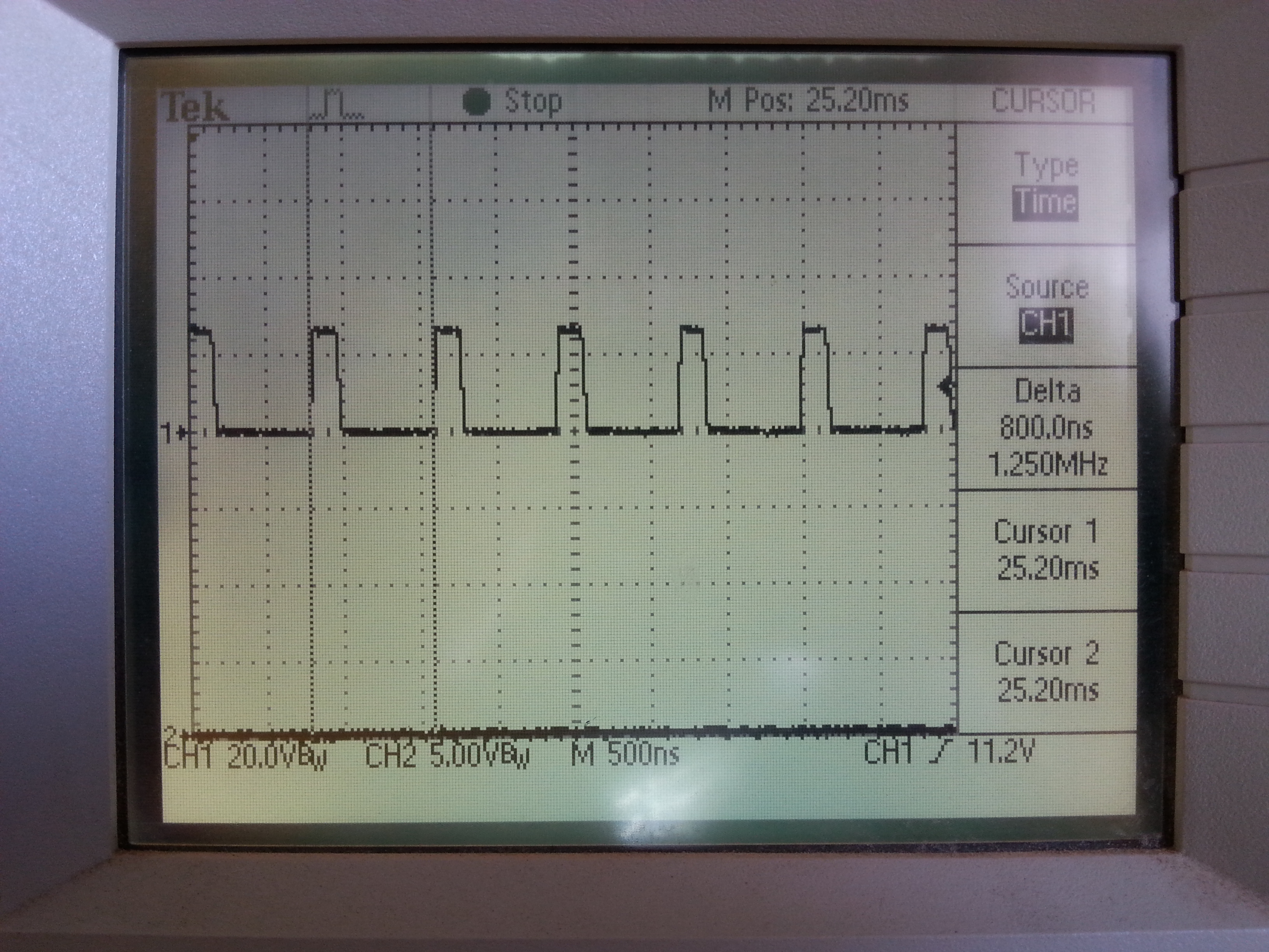

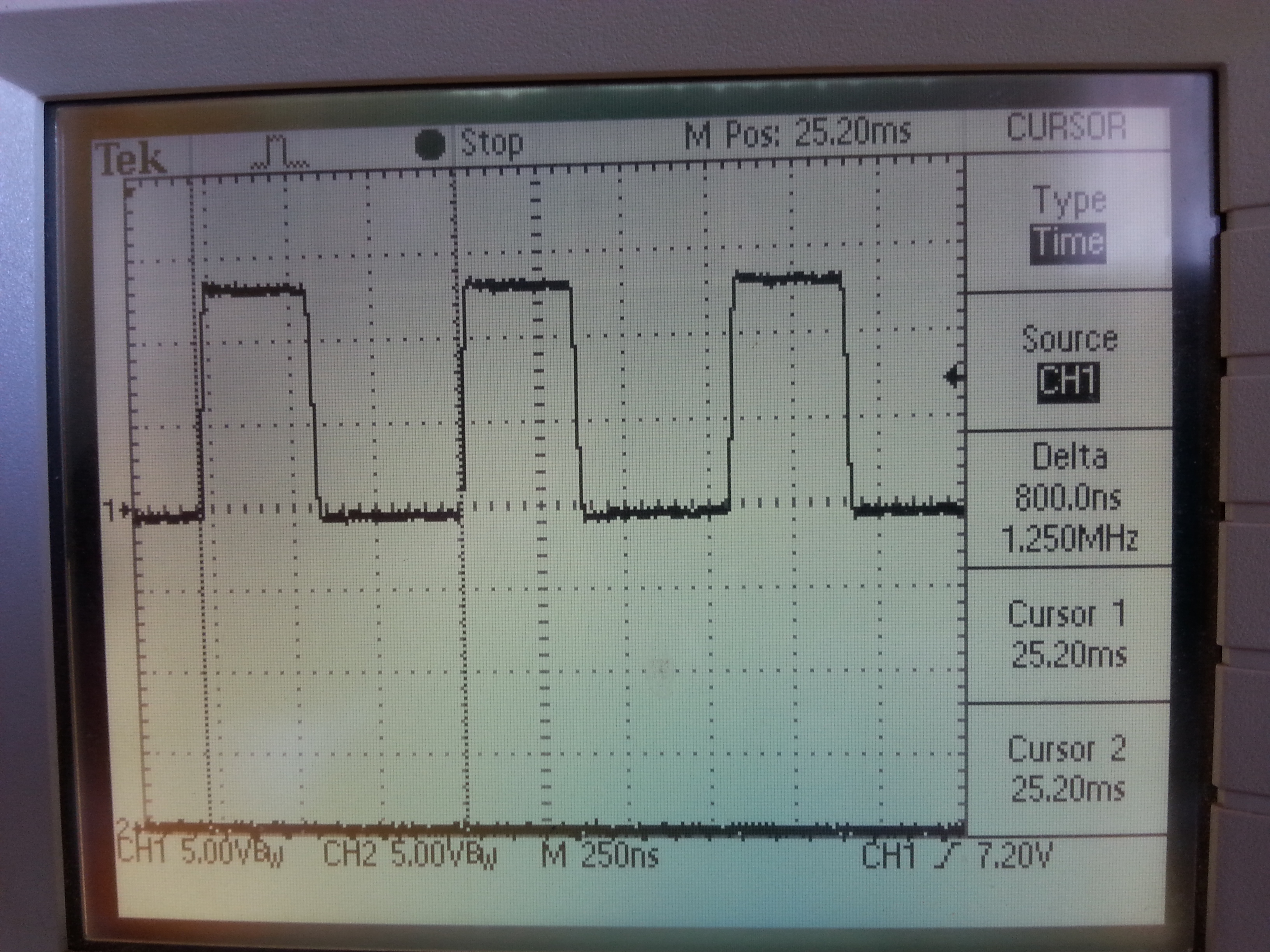

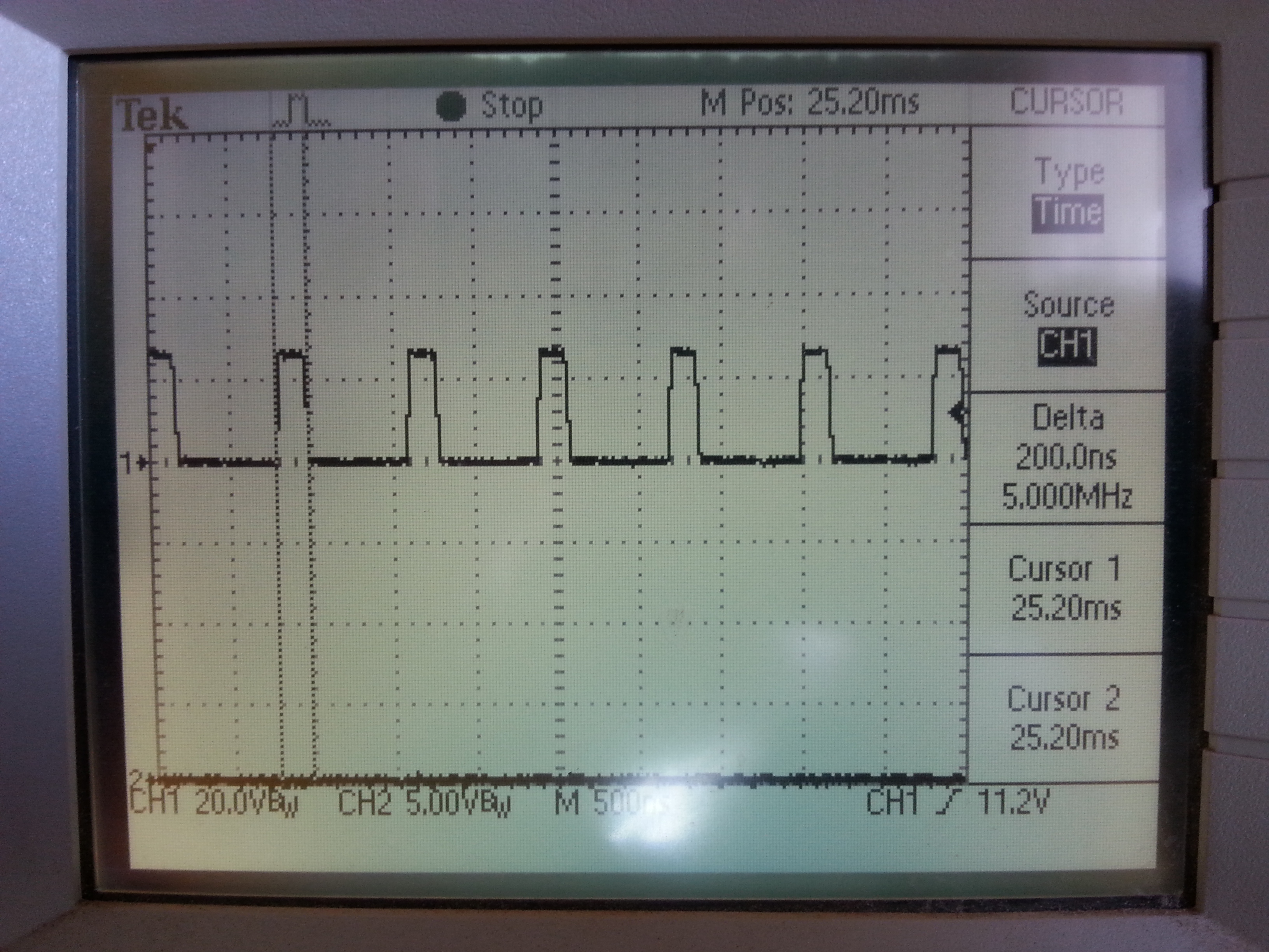

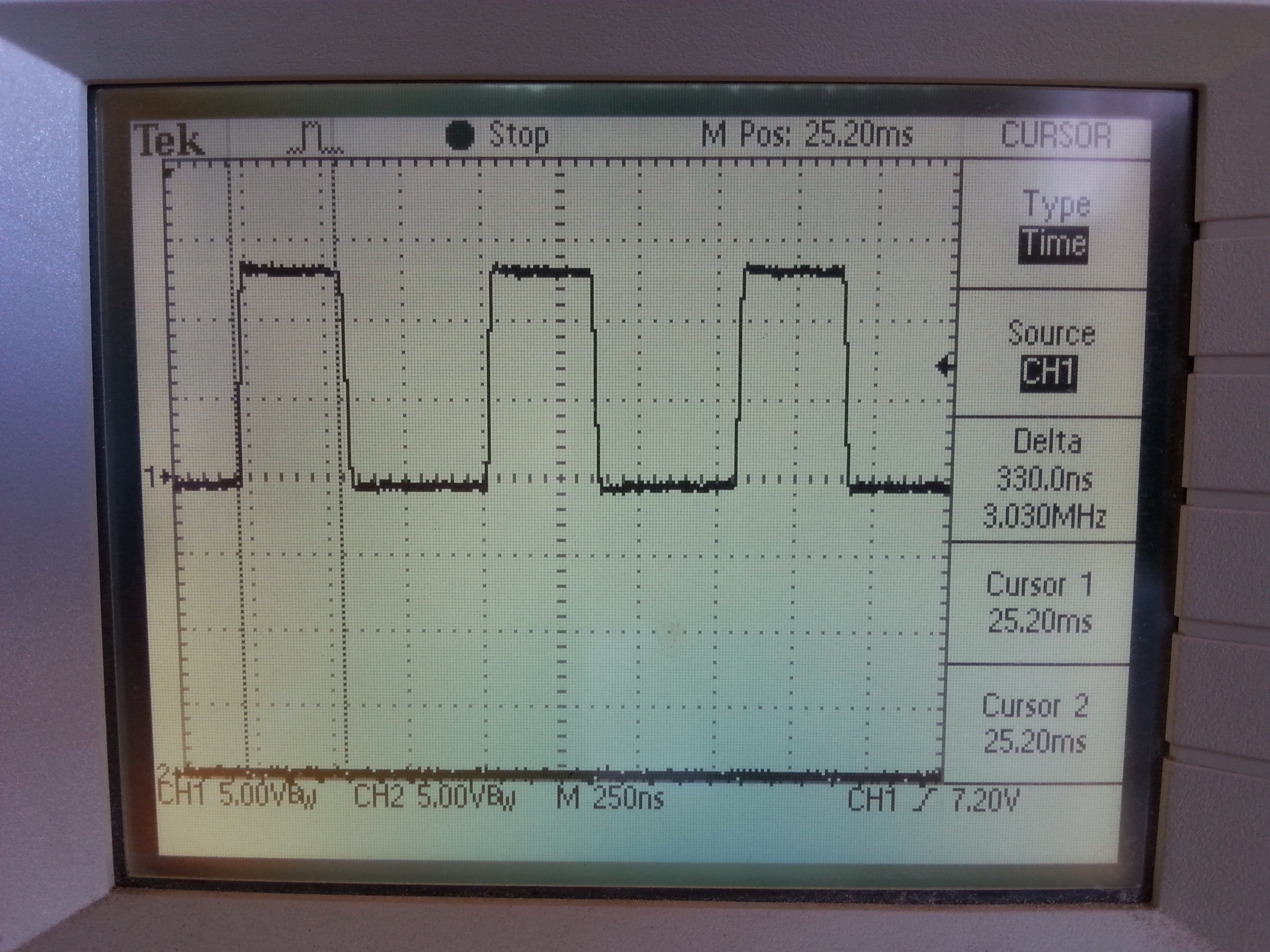

    2. I have lowered the voltage to 12V (possible only in the lab), and checked Vin and SW.
    3. Vin: 5-7mV noise (on 12VDC).
    4. SW: See attached files (see cursors measurements)..

  • Sorry, I should have mentioned to take the switch node measurement with the higher bandwidth so I can see if there is excessive ringing.

  • Hi Marc,
    1. I have tested in 24V. (power up in 12V, and than raised the supply to 24V).
    2. Noise on Vin: 10mV.
    3. SW: looks OK. See attached.
