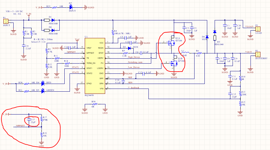

I have design the circuitry of BQ24650 Lead-Acid battery charge controller (2A) by referring to the sluu444a.
This is my schematic.
I testing with power suply, obtained test values (connected with lead-acid batterry 20Ah)
Vin = 20V; Vcharge = 12.88V; Icharge = 0.57A
Vref = 3.28V; Vts = 1.93V, Vregn = 5.95V
Vfeedback = 1.88V; Vmppset =1.18V
If I increase or reduce Vin then Vmppset; Icharge  & Vfeedback not change.

If I remove capacitor C17 - 22pF (connect to MPPSET pin) or I replace C17 with value 10pF and re-connect Battery, obtained test values:
Vin = 20V; Vcharge = 13.86V; Icharge = 1.96A
Vfeedback = 2.05V; Vmppset =1.27V
The question is:
1. Can I don't use capacitor C17?
2. Why I using C17 - 10pF, Icharge increase ~2A, using C17-22pF Icharge = 0.57A?
Thanks for help me!
  • You are allowed to use C17. One of two possible things is happening on MPPSET:
    1. C17 has high leakage. This is causing the DC voltage on MPPSET to change.
    2. MPPSET has a lot of noise (because it's tied directly with VIN through a resistor). In this case, C17 is helping to filter out the noise on MPPSET, which is why the DC voltage is different.
    Can you post a waveform for MPPSET with C17 and another waveform without C17 in the circuit?

  • If you compare the last two waveforms, you can see that the MPPSET has a lot of noise when C17 isn't connected. This means that the average DC voltage at MPPSET is different with and without the capacitor. I recommend leaving the capacitor in there (you may want to play around with the value to see if you get a cleaner signal on MPPSET with a larger capacitor like 100nF).

    I have one question about the choice of mosfet, can you help me?
    Now, I want Icharge = 10A, can I to use the mosfet SI7288DP?
    Otherwise, You give advice how to use mosfet?
    Thanks again!
  • The Si7288DP will work for this application. However, I recommend the CSD18504Q5A MOSFET from TI. The CSD18504Q5A has a lower Rdson and lower Qg when compared to the Si7288DP. The lower Rdson and Qg will result in lower MOSFET switching losses (for both high side and low side MOSFET) and lower driver IC losses (for both high side and low side MOSFET). By my estimate, the CSD18504Q5A will result in 50% lower switching losses and 23% lower driver IC losses when compared to the Si7288DP.
    Calculations were done using equation 16 through 22 on page 22 of the bq24650 datasheet.
    If you can minimized the ringing on the PH node in your final PCB, then you might be able to use 30V MOSFETs. TI has several single channel 30V N-channel MOSFETs and dual channel 30V N-channel MOSFETs (these dual channel MOSFETs are called power blocks and are optimized for buck converters). Please visit this link for an overview: www.ti.com/.../power-mosfet-overview.page .
