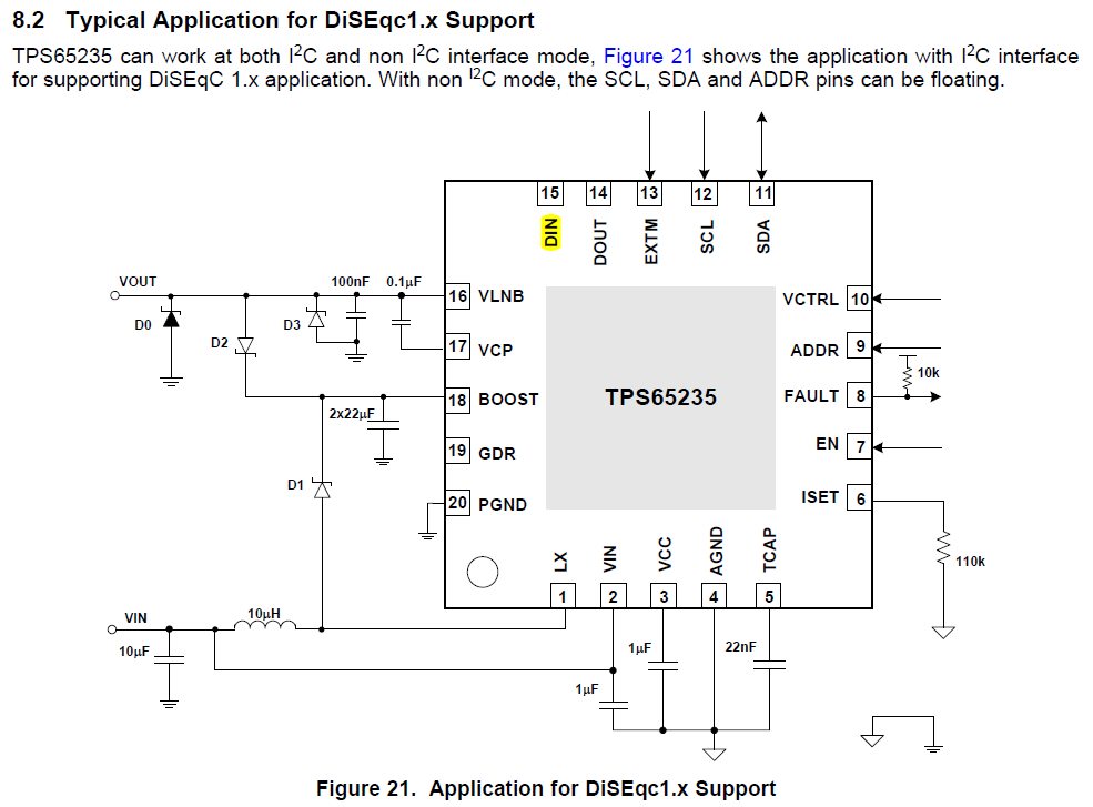

Our customer are evaluating TPS65325 at DiSEqc1.x circuit.
Then, I understand that DIN pin is opened (unconnected).
Is my understanding correct?
If we have to connect DIN pin to the other(GND , VIN etc..), could you please let us know it?
Kanemaru
Hi, Kanemaru
For DiSEqc1.x , the DIN pin can be opened like the diagram. you also can refer to the EVM design. it is opened.
www.ti.com/.../tps65235evm-747
BR
Junjie
Hi junjie-san,
Thank you for your prompt reply.
I understand. Thank you very much.
