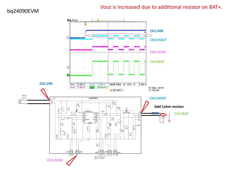

bq24090 has output OVP?
Other Parts Discussed in Thread: BQ24090, BQ24090EVM
I evaluated bq24090 with additional resistor on BAT+ that simulate long wire of battery pack. Then I confirmed charging failure as attached. I guess that the charging is stopped due to output OVP but I can't find such description in datasheet. So please give your comment for following two question.
  1. Does bq24090 have output OVP?
  2. Please give your opinion for this behavior if bq24090 has no output OVP.
