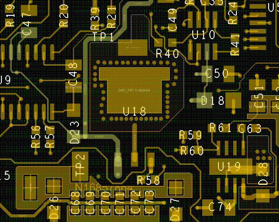

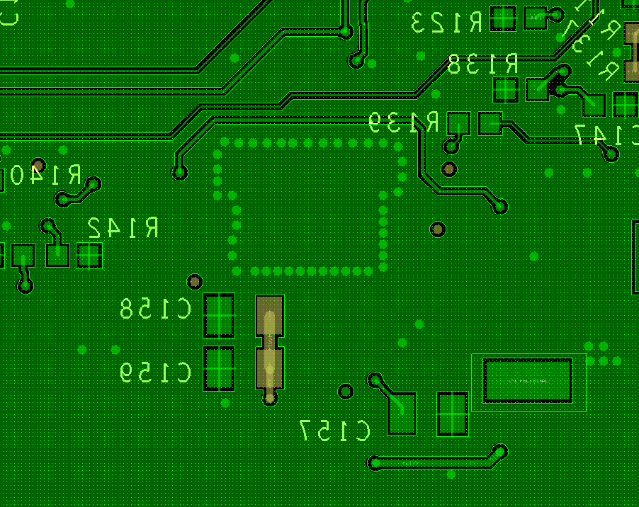

  • Below is regulator circuit
  • Below is regulator layout
Top
Bottom

    I see R58 on the PCB, but I do not see C157 or C158. The output capacitor (and series R) must be connected as close to the device as possible, directly between the OUT pin and the GND pin, on the same side of the PCB that the LM2940 is mounted.
    These components are on the bottom layer (see attachment in original post).  What is the downside to placing C157 on the bottom?

    As for the mounting components on the opposite side, the typical problem is that the via introduces an inductance in series with the capacitance, It's not a lot of inductance, but it might be enough affect compensation. It's not always a big deal, but our general rule is : 'don't do it',
