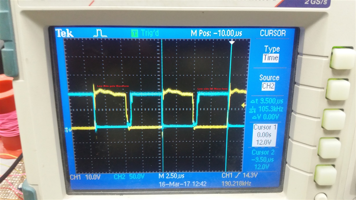

I am working on a two switch forward converter using UC2844A ,Converter Specs are input universal input voltage 90-264VAC,Output 450V DC @350mA. in this power transformer is heating and drain to source voltage of the MOSFET during turn off time is like ramp wave form,not as square wave form, let me know what may be the reason for this?

  • Blue is gate wave form and yellow is drain waveform
    Transformer is ETD 34 with 56 primary turns and Secondary 272 turns divided into two sections 1376,and 10turns Auxiliary winding.

    We are suspecting the body-diode of the low side MOSFET was conducting somehow right after the gate on-time as the Vds level fell slightly below the gate on-time level, this might due to the secondary diode is shorted or in backward bias.
    Could you remove D13 & D16 and test the system with open loop to see if the primary waveforms improve? If the primary side waveforms look good without the secondaries involved, then add the secondary diode back one at a time to see if it makes any change. You might need to confirm the polarities of the secondary windings to ensure both rails are in phase as well before you put the diode back on.
    Also it would be helpful if you can provide higher resolution of waveforms and schematic, the ones you updated were a bit blur and it kind of hard to read the figures.

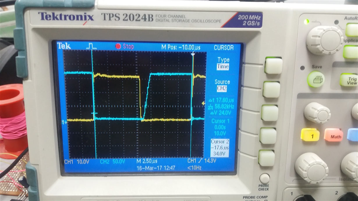

  • thanks for the reply i am sharing the waveform here in this  blue one is secondary side transformer wave form and pink one in primary side with no load and open loop testing...

    It is hard to tell where exactly the problem is, but there are some potential problems based on the information we have so far:
    1. You had placed a DC blocking capacitor C41 on the primary side of the high side gate drive CT circuit, but there is no DC restoring capacitor on the other side of the transformer. This may cause an issue because the high side FET Q1 might not be able to turn on and off properly. I would suggest you to place a same value DC restoring capacitor to ensure the high side FET is properly driven during the operation.
    2. The ringing on the secondary side waveform indicates the inductance of the X’FMR is resonating with the winding capacitances, this suggests the inductance of the transformer might be too high. The resonance frequency will reduce after you place the secondary side diodes back due to the contribution of the junction capacitance of the diodes, and that could be one of the reason why the drain to source voltage is slowly ramping up during the FET off time. Also the reason behind transformer gets hot could be the large winding resistance due to a phenomenon called proximity effect.
    Could you please let us know the inductance and leakage inductance of your transformer? You might need to redesign your transformer by reducing the number of turns to reduce the inductance and the winding capacitance.  Also, interleaving the windings will help reduce proximity effect losses, if your transformer is not already interleaved.

    the above wave forms are at different AC input voltages yellow is gate wave form and blue is drain to source wave form.my bias winding voltage is coming more than the designed value and it crosses the maximum value of IC Vcc voltage this is causing the problem of frequency changing,i am suspecting....is it correct..

    Thanks for your waveforms, I am having some confusion here would you mind clarify them for me?
    1. You stated earlier, "Transformer is ETD 34 with 56 primary turns and Secondary 272 turns divided into two sections 1376,and 10turns Auxiliary winding" and in the most recent post you said: "i am using ETD 34 Core and Primary having 47 turns and secondary having two sections with 117 turns and primary inductance is 6mH,leakage 22uH, winding pattern is first primary then secondary winding last is bias winding.". Which one is the correct one?
    2. The waveform you have provided does not have the slow ramp for VDS? Does the DC restore capacitor help? What was the test condition i.e. loads, input, output?
    3. I am suspecting the frequency variation was caused because the internal regulator for VREF was burnt due to your auxiliary winding voltage exceeded the maximum VCC rating.
    Can you measure the auxiliary winding waveform as well as the VREF pin voltage under different AC input? The maximum rating for the VCC pin is +30V, the device will be damaged if you exceed this point.
