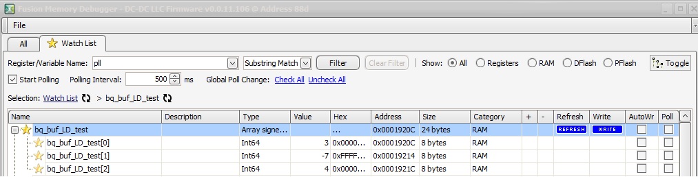

I also define all the variables as EXTERN variables. The bq_buf_LD_test[3] array is for comparison.

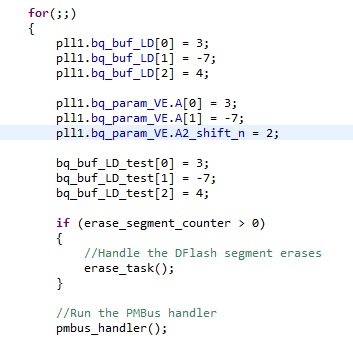

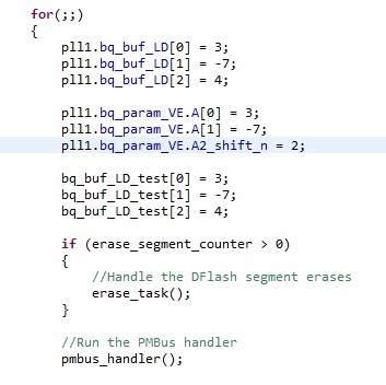

Then, I tried to assign values as follows:
The code can be compiled successfully, and the value of bq_buf_LD_test[3] is correct.

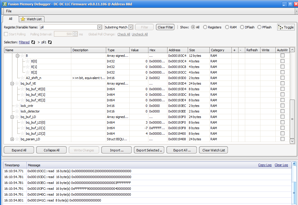

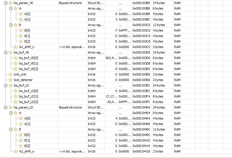

But the values of pll1.bq_buf_LD[3], pll1.bq_param_VE.A[2], and pll1.bq_param_VE.A2_shift_n are wrong,
It is such a simple code and I don't know why the assignments are not correct.

Thank you for your suggestion. I tried to remove all the /* and 2*, but still can not work. After I changed the order by moving all the int64 variables to the bottom of the structure definition, it worked correct. The project is attached belowTest_PLL_try.zip
The issue here was that Int64 wasn't fully supported by the memory debugger. This variable type has a self alignment rule and needs to start at the beginning of a word boundary in the memory. The memory debugger was not taking this into account for this type. The reason it worked after you moved it was because it coincidentally aligned to the word boundary. A new build will be released soon covering this error and posted to the net. Thank you for providing your project to help debug this issue.
