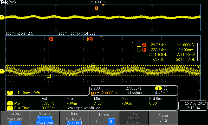

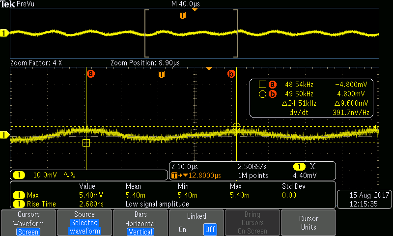

The issue is that both buck outputs has a sine wave on the output voltages. The sine wave on the 1.35V output is 31mV with a frequency of 24.5kHz as shown below. The 1.8V output has a similar sine wave but the amplitude is lower. The current drawn on the 1.35V output is 0.7A
The sine wave on the 1.8V is ok because it is a small percentage of the voltage, but I would like to get the sine wave on the 1.35V output smaller.
Any suggestions?

Did some voltage captures of the 1.35V rail with different loads. Capture below shows the board idling with no additional loads.

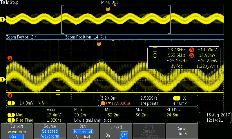

Capture below shows the board with 10Ω resistor load added to the 1.35V rail.

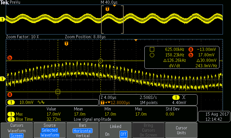

Capture below shows the board with 1Ω resistor load added to the 1.35V rail.
Thanks for attaching the scope shots.
Unfortunately, if the sine wave on top of the output voltage is the same across loads (~25 kHz), then it is not coming from PFM.
There is no 25-kHz clock in the LM26480 and even if there were it would not produce such a smooth waveform.
The only conclusion that I can draw is that the 25-kHz wave is being coupled onto the output voltages from somewhere else (hence, this is a conducted EMI issue).
If the interference is off-board, then moving your testing setup may help resolve the issue. If the interference is on-board, it may be difficult to isolate the source of the interfering waveform. Do any other ICs on the PCB use a 25-kHz clock (or a multiple of 25-kHz that gets divided down, such as 50, 100, or 200-kHz)?
