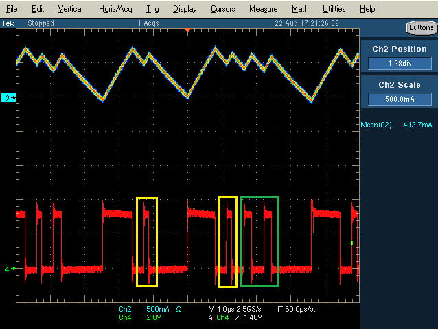

Hi Team,
My customer is evaluating TLV62569 with TLV62569EVM.
He found yellow SW pin  pulse width is thinner than green.
The load current is around 0.4A and I believe it is boundary state between PSM mode and PWM mode in this case.
CH2 (white): inductor current
CH4 (red): SW pin voltage
Could you kindly tell me why yellow pulse is thinner than green one?
Yaita / Japan disty
  • Hello Yaita,
    it is a pleasure to support you. May I ask you how you setup your feedback devider (resistor values and feedforward capacitor), and if possible to superpose the waveform of the output voltage to the screenshot you sent me ?
