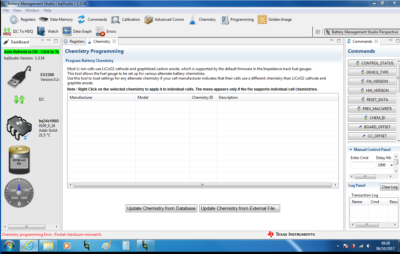

We have used the online tool to get a new Chemical ID for our battery, which is 2133.
In Battery Management Studio, Chemistry programming,  Chem ID 2133 is not available.  There is a button "Update Chemistry from an External File" which I have tried to use. I have downloaded sluc564do containing ChemUpdate597, and sluc261 containing various files, which seems to include the chemistry for ID2133.  Unfortunately I don't know how to use this information. Do I need to run "Chemical Updater-597-windows-installer"?
I should be grateful for any guidance on getting Chemical ID2133 into the BQ34Z100-G1

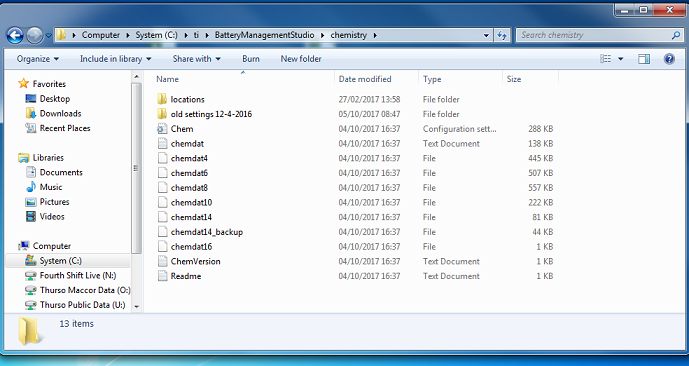

  • Hello Alan,
    Copy those files contained in the chemupdater www.ti.com/.../sluc564 and replace the exiting files in the directory of your own computer below with those copied and you will be able to see chem id 2133 to program on the gauge.
    C:\ti\BatteryManagementStudio\chemistry
    I hope this helps

  • Hi Onyx,
    Thanks for the instructions, but please see the screen shots above as something hasn't worked.
    As you can see, the new files in the Chemistry folder copied across OK, but when I open BQ studio and go into chemistry, no IDs are listed at all.
    I tried some simple things like restarting BQ studio and restarting the computer but they make no difference.
    Alan

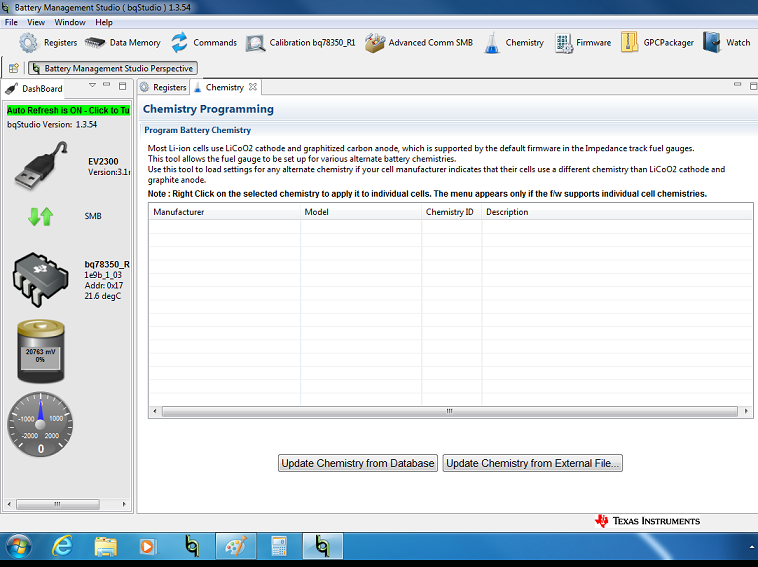

  • Hi Onyx, it didn't work and I have just posted a reply with some screen shots illustrating what happens.
    I look forward to hearing back from you.
    Alan
  • Hi Alan,
    Your screen shot post is showing the bq78350. That device uses CEDV and does not use chem ids so you shouldn't try programming a chem id on there.
    thanks
    Onyx
  • Hi Onyx,
    You are right of course! We have both chips in our circuit and I was plugged into the wrong one.
    I was certain then, that when I connected to the BQ34Z100G1 it would all work.  But it still didn't.
