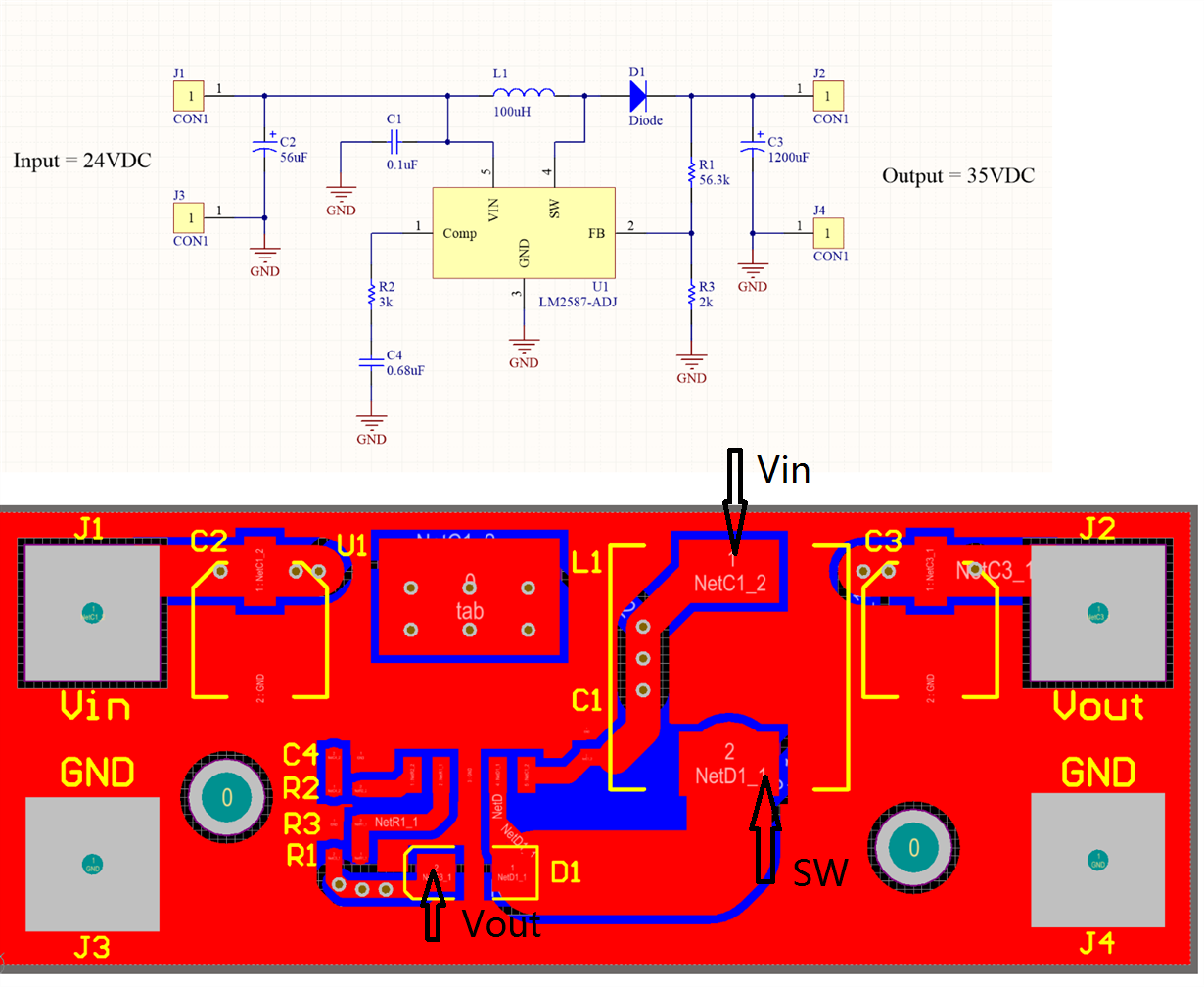

Recently I bought several LM2587-ADJ/NOPB, and now I meet some problems with application provided by datasheet.
Input 6V, 1A, DC source. The output side we connect 100ohms power resistor.
Actually, the circuit behaves well with no load, the output voltage is exactly like what we set 12V. However, as 100ohms resistor connect to the output side, the output voltage drop significantly, like 6-8V, and sometimes the chip gets hot and burns out.
Ask for help! How to set the output voltage when we get a load.

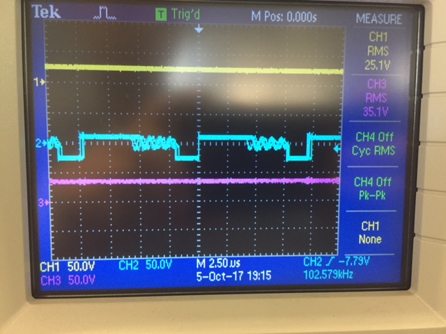

to help me analyze this question, Could you do some test and post some waveform?
I want you to save this point waveform: Vin SW and Vout. Please put voltage probe as I draw in the layout. if you can test inductor current at the same time, it is the best.
(1) in open load, test start up waveform and steady waveform.
(2) in heavy load like 600mA, test the start up waveform and steady waveform.
