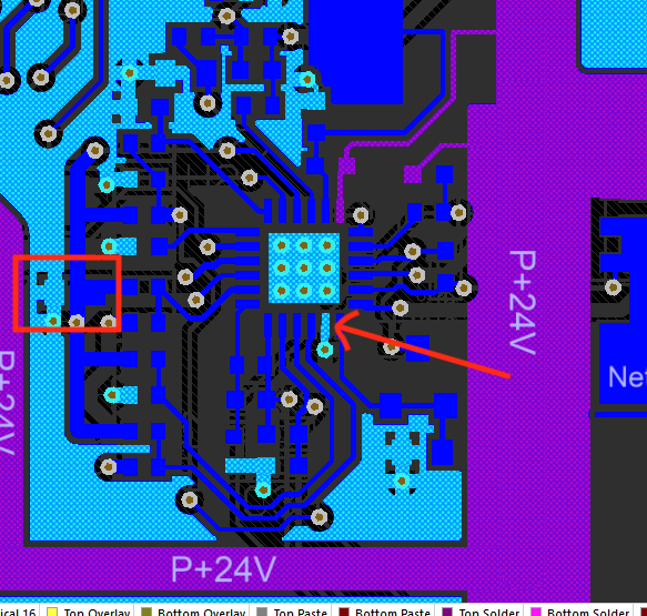

    In the mean time I did find an error. See the redblock in the schematic below. The junction is missing, so two pins  (R41 and R43) was not connected to GND. I have fixed that, but of course the reference is still wrong, so I will replace the chip again now that this error is fixed.

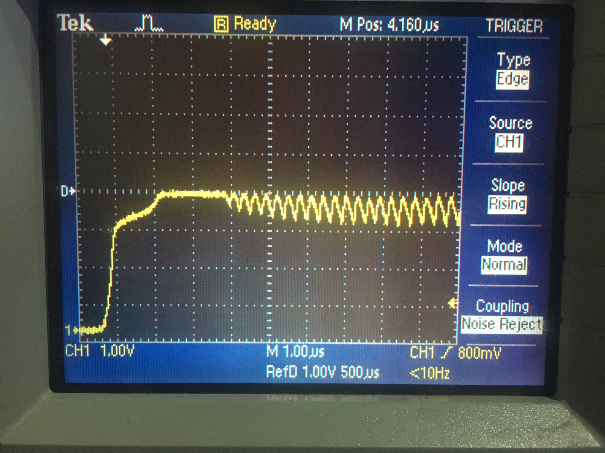

    Another scope trace of VRef with 1us timebase
  • What is the bandwidth setting on your scope?Please use full bandwidth setting.
    VREF oscillates in your scope capture from 3V to 3.8V. Is the IC switchin? Can you plot VCC and VREF at the same scope capture?

    Below are three plots of the Vref and VCC at 3 different sec/div values. The trigger is setup on VRef. Full bandwidth is used (it is a 2GS/s (200MHz) Tektronix). The oscillations on VRef are at 2.38MHz.

  • From your scope capture, the oscillation on VREF is ~2MHz. The bq24630 swtiching frequency is 300kHz. Thus the bq24630 cannot generate 2MHz oscillation. Plus, you have confirmed the converter is not switching at all. Since there is no other load connected at VREF, then the problem leads to be ground connection. Please double check your ground and make sure they are properly connected.

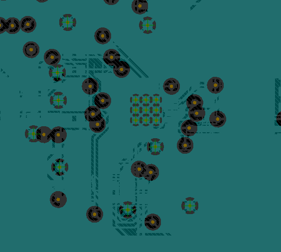

  • Jing, the PCB is a 4 layer board with ground and power internal layers. Below is snapshots of the area around the chip. The red arrow points to pin 17 for ground connection. It has via directly to ground plane right at the pin. The other picture is of the ground plane.
    As you can see, the middle pad is also connected to ground with multiple vias.
    I also just double checked pin 17 under microscope and it is soldered well. I cannot check the power pad, but it "should " be soldered ok after the reflow.
    I also checked to make sure that the ground is not isolated by any means ( like a island in plane etc).

    Where do you place C33? The VREF is simply a LDO, so either the problem is on the input side or the output side. The input from your scope capture looks pretty stable. Thus we need to take a close look at the output. From the layout capture, we cannot tell where is C33 (VREF cap) placed at. Would you prefer take this off line so that you can share more detailed layout file?
  • How do you measure the VREF voltage? In other words, where is your ground reference when you capture the waveform. Did you use the GND of C33? Or pin 17? or somewhere else? Can you directly probe the voltage across C33?
  • The GND I used was a little further away than I would have like, but now I measured it just over the cap. Below are the traces at different sec/div resolution. You will notice it is almost as if the chip is trying to regulate at 3V3 for 3ms but then gives up and goes ballistic.
    Hope this can give you some new ideas. Can we skype chat about it, its a little more interactive and then we don't clutter the forum with all the screenshots.
  • Discussion moved off line. Customer added 100nF cap which solves the problem.
