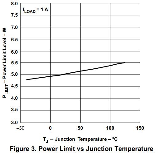

TPS2421-1: Power Limit variation by VIN, ILOAD
Part Number: TPS2421-1
I would like to know Power Limit variation by VIN and ILOAD.
"Power Limit vs Temperature" shows on the datasheet as below;
Could you provide the such data "Power Limit vs VIN" and "Power Limit vs ILOAD"?
Kuramochi
  • Hi Kuramochi,
    The power limit tolerance depends on the process variation & temperature and has very less dependency on Vin, Load current parameters.
    You can treat worst case value as 3W while designing your system.
    Rakesh
