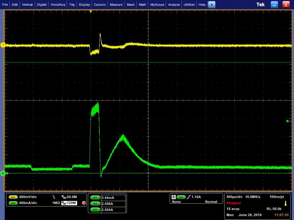

The TPS63010  circuit provides power to our product which has an LED to provide lighting. When the LED is turned on there is a high inrush of current. After a high inrush of current this regulator goes into a bad state where the voltage drops to about 2.4V, The AC coupled ripple voltage, the input current and the output current are shown below when in this state.
 Is there anything we can do to keep from going into this state?

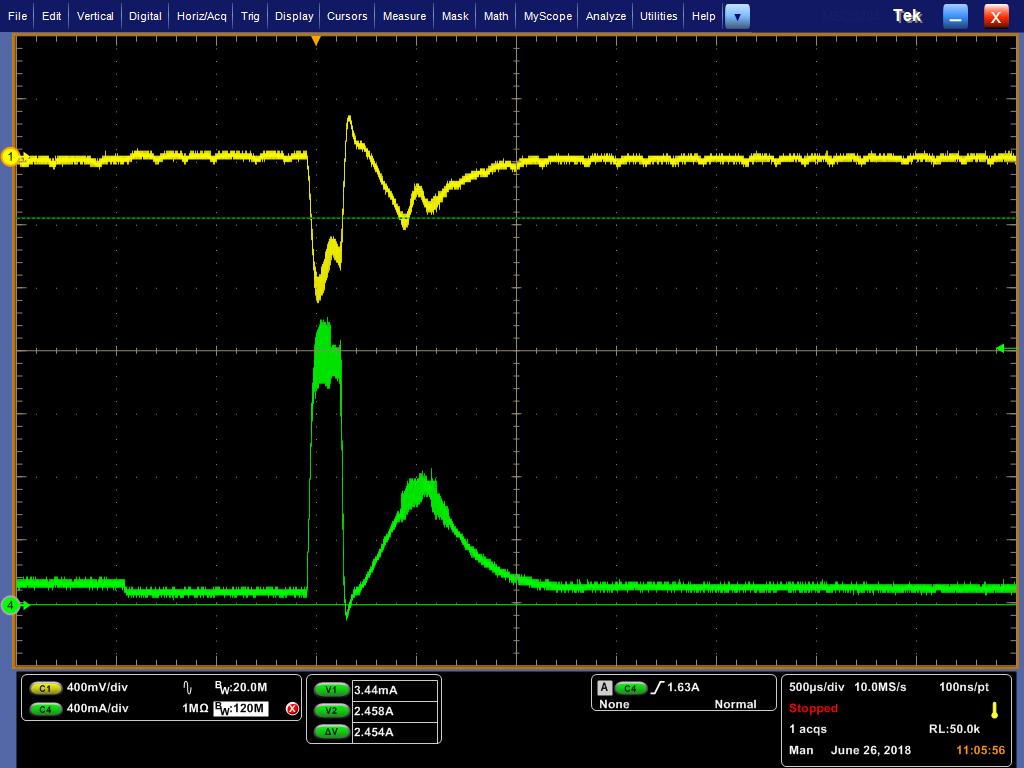

  • Input
    Output
    We changed the TPS2553 to a TPS25221 that is set up for a 2.3A. The TPS63010 works fine in this configuration. There is still a large droop on the input voltage when the inrush of current occurs. Attached are 2 oscilloscope traces for input current/voltage and output current/voltage.

    Ok, so we know now that the combination inrush current limit plus TPS63010 is not working. It is interesting that removing the load does not recover the TPS63010. We will try to reproduce this in the lab.
    You could try to reduce the input voltage drop by adding more capacitance on the input and therefore reducing the input impedance. Normally the output voltage drop should then be somewhat reduced as well. Additional capacitance at the output should help here as well.
