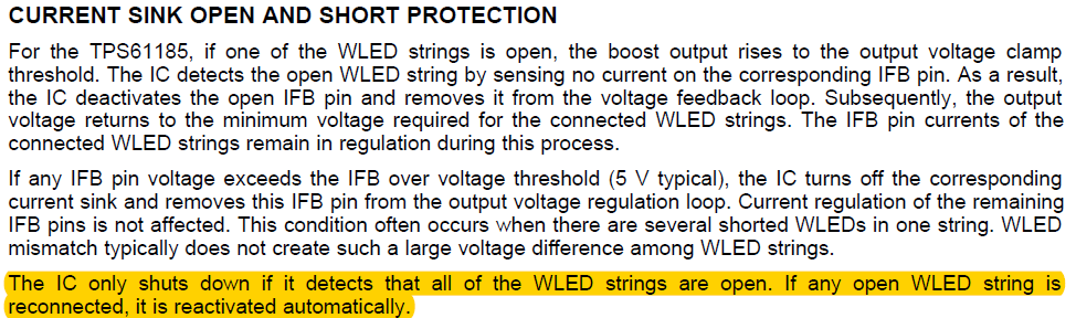

From customer test result, the boost output voltage is OVP voltage when no LED is attached. It seem not match with D/S.
Is it normal? Thanks.
