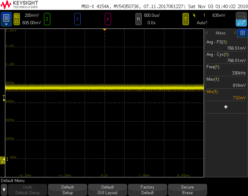

1. When the highest current step is chosen and dimming is disabled the measured waveform is constant dc current. In the capture below the waveform is as expected.
Register Dump: {'high_time': '0x80', 'low_time': '0x0', 'enabled': True, 'high_level': '0xff', 'step_size': '0x80', 'dimming_enabled': False, 'delay_time': '0x0', 'fall_time': '0x0', 'low_level': '0xe0', 'rise_time': '0x0'}
Now, when we drop the current step one level I am expecting to see a constant dc current with a smaller magnitude. However the resulting waveform has a PWM element. Why is the current not constant?
Register Dump: {'high_time': '0x80', 'low_time': '0x0', 'enabled': True, 'high_level': '0xfe', 'step_size': '0x80', 'dimming_enabled': False, 'delay_time': '0x0', 'fall_time': '0x0', 'low_level': '0xe0', 'rise_time': '0x0'}

  • Hi Sean,
    Let's focus on question 1.
    Both of the waveforms shown in question 1 have dimming disabled for the diode we are using D1. (register 0x10 = 0xB1)
    The only thing that is changing from the first waveform to the second is the high_level register 0xA9. (waveform 1: 0xA9 = 0xFF, waveform 2: 0xA9 = 0xFE)
    Given that dimming is disabled and the only register change is to the high_level why is the second waveform not DC?

  • Hi Sean,
    The first three images attached show the waveform with dimming enable, dimming disabled. What register settings should be used to get a constant current?
