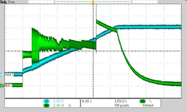

    In testing, charge looks something like the following:
    You also need to consider how much power your input can provide. Depending on the voltage you need to charge the capacitor stack to, the current will change to meet the 10s charge time.And your input can potentially limit this if the power needed is too large.

    I have some more questions according to the oscilloscope print screen.
    The current on the screen shot seems to shows three phases:
    1. 5.8A for 2 second => What hapens here?
    2. about 7A for 14 seconds => This could be the prechage phase. Did you use a smaller Rsr of about 0.5mOhm to reach a 7A chaging current?
    3. 10A ramping down => This will be the fast charge phase. Is the current ramp down caused be the limited primary power?
    Adi

  • Hey Adi,
    So I was able to mostly replicate that waveform. In order to prevent very high ripple current to the output, there is a current clamp on the current delivered to the output while the battery voltage (here shorted to VSYS) is below a certain threshold.

  • Hey Adi,
    In this configuration, there is no pre-charge phase. This charge controller only limits current if the LDO enable option is on, which by default it is. However, for a super capacitor configuration like this one, you will want to disable this function. The LDO function mimics a "pre-charge" phase, but in reality it is only there is protect the PMOS BATFET. I shorted across BAT and SYS for this test which removed the need for the LDO mode.
    The current ramp down is due to the voltage on the supercapacitor approaching the programmed battery regulation voltage. This, in a battery configuration, would be called Constant Voltage (or CV) mode. Here, the output voltage of the charger is regulation to a voltage rather than regulating the current. In this state, the current is only dictated by the VSRN (programmed) - VCELL (supercap voltage) divided by the line resistance between those two nodes.
