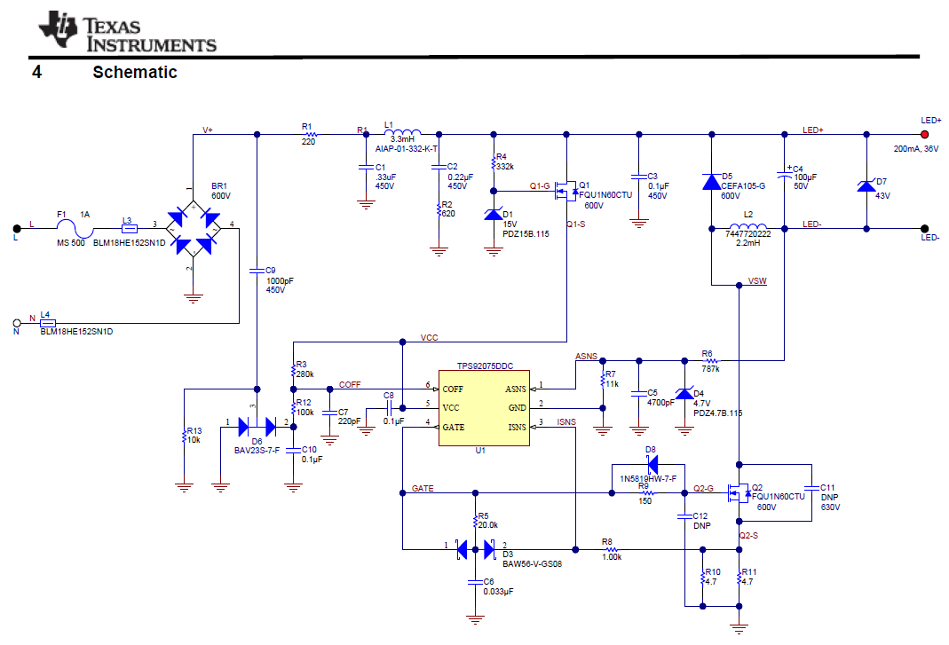

I have to develop a new board.
Requirements are:
Input 230Vac, Triac (or IGBT) dimmable
Output: LED 12V, 500mA

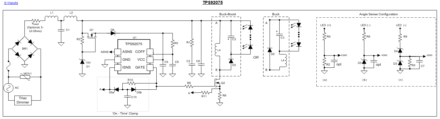

I follow TI PMP6016 eference design where I can see buck solution:
In TPS92075 datasheet and in TPS92075 DesignCalculator is suggested to use buck driver and angle sense configuration with straight resistor divider beetween LED+ and GND.
So, I can see that on Reference design "Angle sense Configuration" is a straight resistor divider beetween LED- and GND, not beetween LED+ and GND.
Why this difference?
What is the solution that I should follow?
