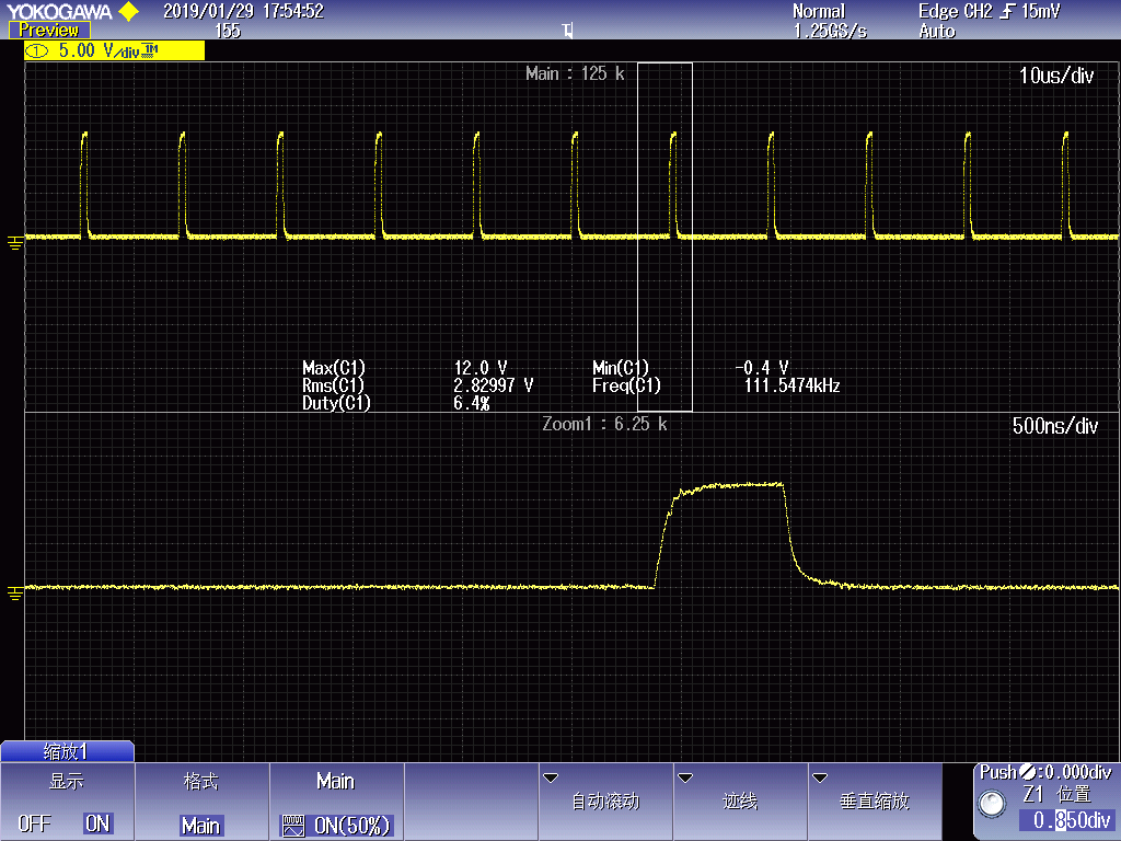

My customer use UC2845 to make a flyback. Vin=24V,6*Vout=24V,One 12V auxiliary winding output, oscillation frequency 220 khz, output frequency 110 khz, optocoupler feedback. They met a problem.
At present, the duty ratio of the transformer's input terminal is 4-11%, and the input and output power is small. We want to increase the duty ratio to increase the input and output power. However, several transformers have been replaced, and the duty ratio can not be adjusted (want to be adjusted to about 30%), basically maintained at about 9%, and the input power is about 8.6W. The schematic is as attachment.

  • Hi Peter,
    Transformer output 24V and Vin 24V waveforms as attachments. Other pins waveforms have been damaged, please wait a little longer time.

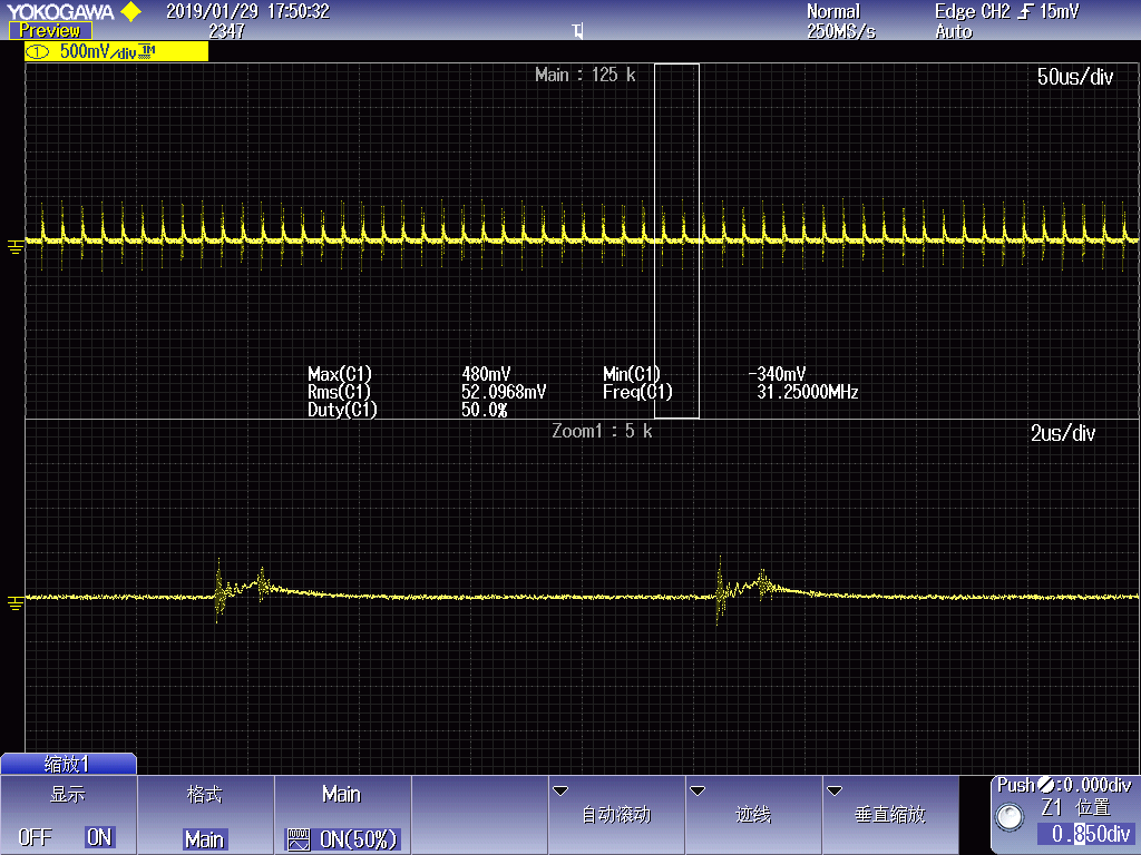

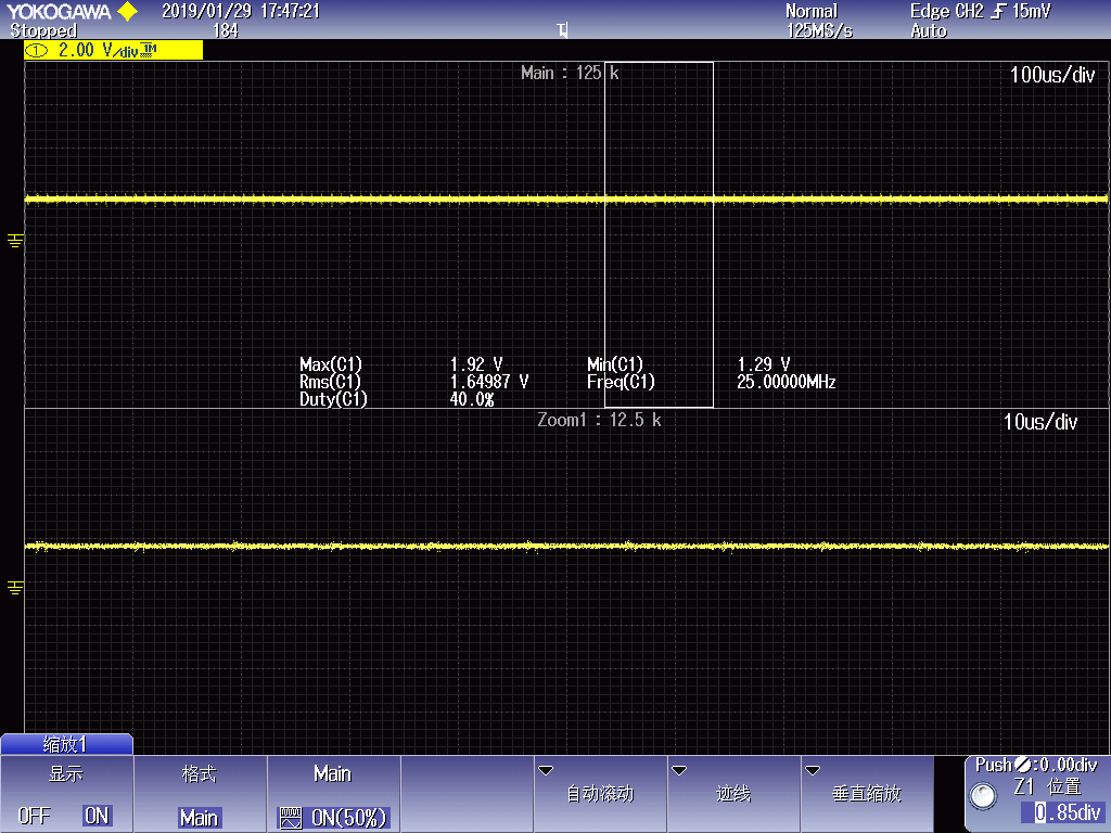

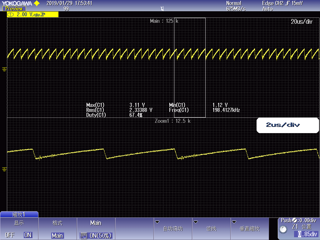

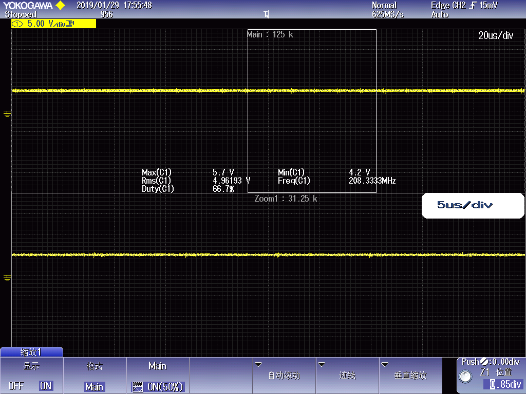

  • hi Peter,
    The waveforms as attachments. Please refer ,thanks!
                                                                                                                 COM pin
                                            ISEN pin waveform
                        PWM OUT Pin waveform
                          VI waveform
                            VREF waveform
       Oscillation waveform

  • Hi Kun,
    The COMP pin voltage is about 1.6V, this voltage level is been set by the voltage control loop on the secondary side, based on the TL400 (TL431).
    As the load on the power supply increases there should be a small drop in the output voltage this should cause the TL431 to shunt less current so the voltage on pin 1 of the opto-coupler should rise as the output load is increased.
