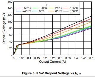

My customer is evaluating our TLV758P. The target output is 4.8V. But the minimum input can be dropped to 4.75V so they want to check the Vdo under 4.75V input and 4.8V target output. The load current is 100mA or 500mA.

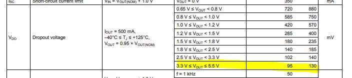

I checked our datasheet that the maximum Vdo with 500mA Iout is 115mV for this use case. But I just want to check with you if we have the Vdo data for 100mA Iout condition.

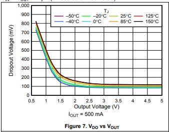

I think it should be calculated as 115mV/500mA*100mA=23mV. But I am curious that if it is just a linear relation between Vdo and Iout, why Vdo is also related to the different Vout range according to TLV758P datasheet? Thanks.

    While your approach is correct for many linear regulators, it is important to make sure that you are always using the current version of the datasheet.  When we released the TLV758P to marked, our maximum for dropout was increased slightly to 130 mV.
    You are correct that dropout normally has a linear relationship with Iout; however, as you can see from Figure 6 in the datasheet, dropout is closer to 40 mV at 100 mA.
    As you mentioned, there is also a relationship between Vout and dropout.  Chapter 1 of our LDO Basics e-book briefly discusses the variables that impact dropout.
    www.ti.com/.../slyy151.pdf
    For linear regulators with PMOS pass FETs, as the input/output voltages increase the minimum headroom (Vin - Vout) or dropout required for regulation will decrease.  This is because the LDO you will have a larger delta between Vin and the gate voltage which will allow the FET to be less resistive.
    www.ti.com/.../sbvy001.pdf
