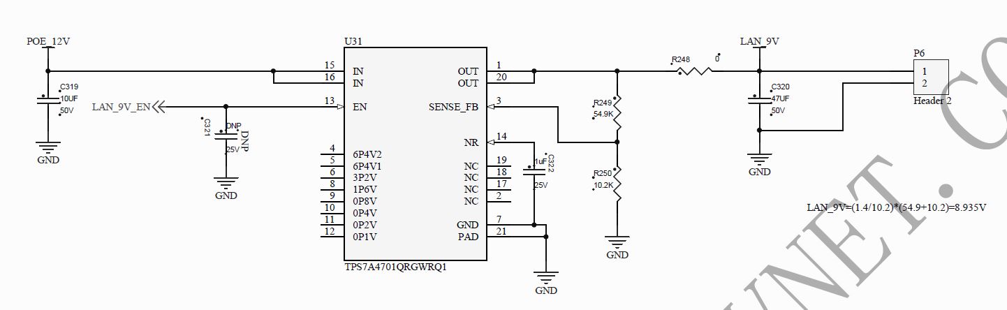

TPS7A47: Could you kindly help to check the below schematic, and give some advice about it.
