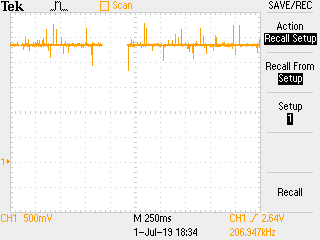

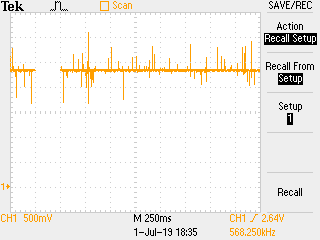

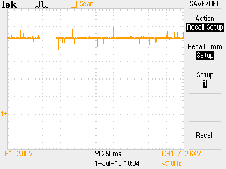

    Please see the waveforms below as per the test conditions.
    1. Without Battery Connected, Input Voltage = 21V DC
    SRN Waveform:
    2.   PH waveform:
    Battery Connected. Below screenshots of SRN, PH and Ammeter screenshot of the Battery connection.
     SRN Waveform:
    PH Waveform:
    c) Charging Current thru Ammeter with Battery Connected
    Also, please note that we have assembled two boards and we have the same issues with both the boards. We have even tried changing the device on one board, but the function does not change.
    Rajesh

  • Hi Rajesh,
       These waveforms don't look like correct operation. PH should be switching from VIN to ground and should be visible in this time scale, even if battery is absent. Your waveform on battery absent shows PH with basically a DC value of ~2.5V even though input source is specified as 21V. The difference in max value of PH is not affected by absence or presence of battery as is shown in the waveform results above. Also SRN shows no oscillation on above waveform as it should during battery absent detection as can be seen in Figure 13. of the datasheet. SRN should be oscillating between maximum charge voltage (set by resistor divider network at VFB) and VLOWV. Please refer to below attachment on how to design schematic and BQ24650 design considerations. I would also direct you to test on BQ24650 Evaluation Module to verify correct operation.
