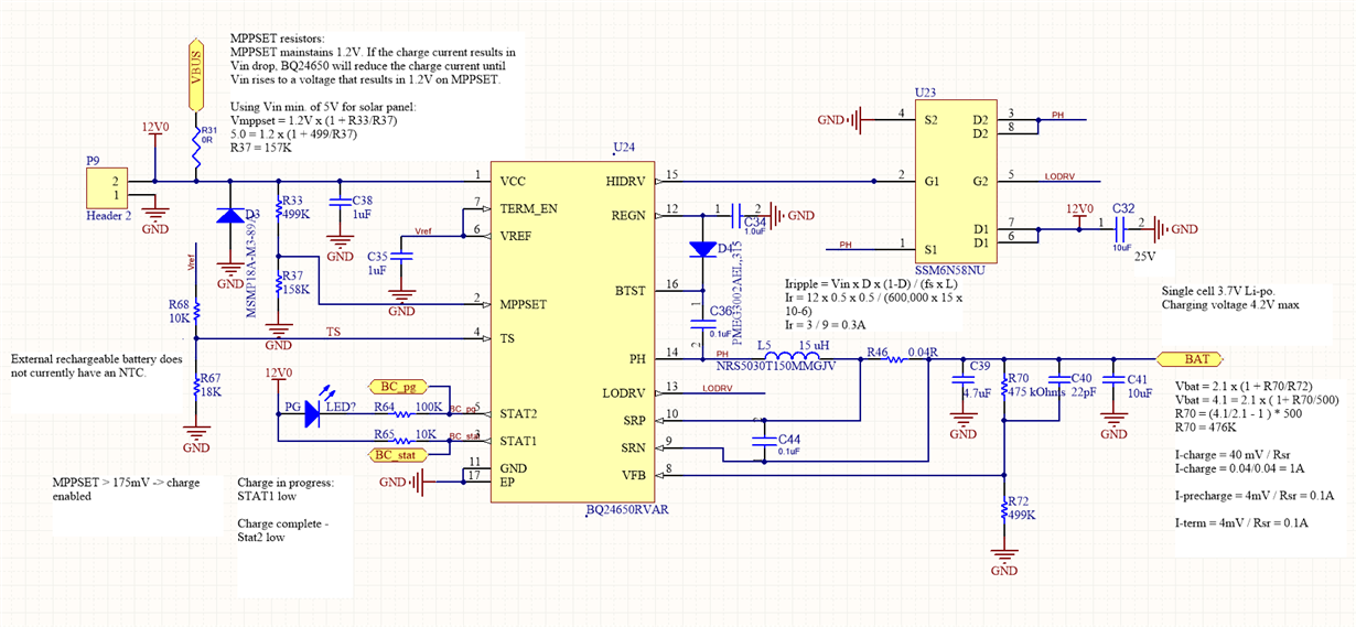

BQ24650: BQ24650 circuit not charging Battery
Part Number: BQ24650
Please see the schematic screenshot attached.
Vin: 12V (DC Adapter) or 5.0V coming from USB
Vbat: 3.7V lipo (4.2V max charging voltage)
Measured:
Vref: 3.3V
Vcc: 12/5V
MPPSET: 1.2 (with a 5V source), 2.94V with a 12V source
TS: 1.6V and 2.19 V (tried 2 different R67 values)
LODRV has pwm pulses
V-regn : 6.0v (with a 12V source), otherwise 5.0 with a 5V source
Vfb: 1.95V (Vbat = 3.93V), charge termination voltage set at 4.1V
The stat1 pin is pulled low (LED on) while stat2 pin is high indicating that charging is in progress but the Vbat remains at battery level and battery never charges. I am not sure what I am missing or doing wrong.
Please help me identify the issue.
Thanks in advance.

  • the schematic did not attach properly with the original post:
  • Hi Noaman,
        Do you observe normal charging at VIN - 12V, and no charging even though STAT1 indicates charging with 5V input?,
  • Hi Kedar,
    No, it does not charge with either 12V or 5V.
    Stat1 indicates charging in either case. One thing I have observed is that stat1 indicates charging even when no battery is present.
    Noaman
  • Hi Noaman,
      It looks like you have an issue with HIDRV signal that is used to drive the HSFET. The charge current isn't being sensed so the converter is trying to drive the HSFET on for the full cycle. The schematic looks fine, and the external MOSFET selection doesn't seem like an issue. Most likely the issue is with layout and the routing of the HIDRV or BTST.
    Please also re-test with replacing C39 with a 10uF capacitor
  • Hi Kedar,
    Here is the layout of the mosfet section. It is right next to the IC with a very short trace between the BQ24650 and FET.
    I tested with 10uF quickly and did not see any charging.
    We soldered another board and on that board, no LEDs are lit indicating some sort of fault. VCC is good, Battery is present and TS values are as per schematic. Not sure where the fault could be.
    If there could be any other issue, please do let me know.
    Noaman
  • Hi Kedar,
    we got the circuit to work on the 2nd board. May have been soldering issues.
    Noaman
