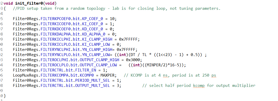

How to Configure the register parameters?I refer to TI LLC HB code,to Configure the DPWM and Filter register。Now I can adjust the frequency by EPA0 input, But i can't Limit maximum operating frequency (Can Limit Minimum frequency ).And I don't konw how to adjust the duty for 50%.
Here are some of my code(If have any suggestion or have any mistaken please tell me):

    I add Autoswitch Function. Now i get the 50% Duty Cycle DPWM, But I can't adjust the period by the EAP0 input。
    DPWM always stay in the MAX period . I don‘t konw what register i Configured going wrong
    Here are some of  my code of  DPWM and CLA:

    Can you control the filter output using either the high and low clamps or CPU_SAMPLE.  If you can change the filter output this way, you can prove that the filter is updating.
    Then verify that the filter output is getting to the DPWM.  You can read the filter duty register in the DPWM.  I think it is also valid for the LLC, and it should be a filter period as well.  If that value isn't correct, you probably need to look in the LOOP MUX to make sure that the filter is hooked up to the DPWM correctly
    If the filter duty is valid and has the value you expect, then verify that you have all the mode switching stuff hooked up correctly, and make sure that it is enabled.
    If the filter duty is changing, but not correct, then you need to look at the signal chain between the filter output and the DPWM.
