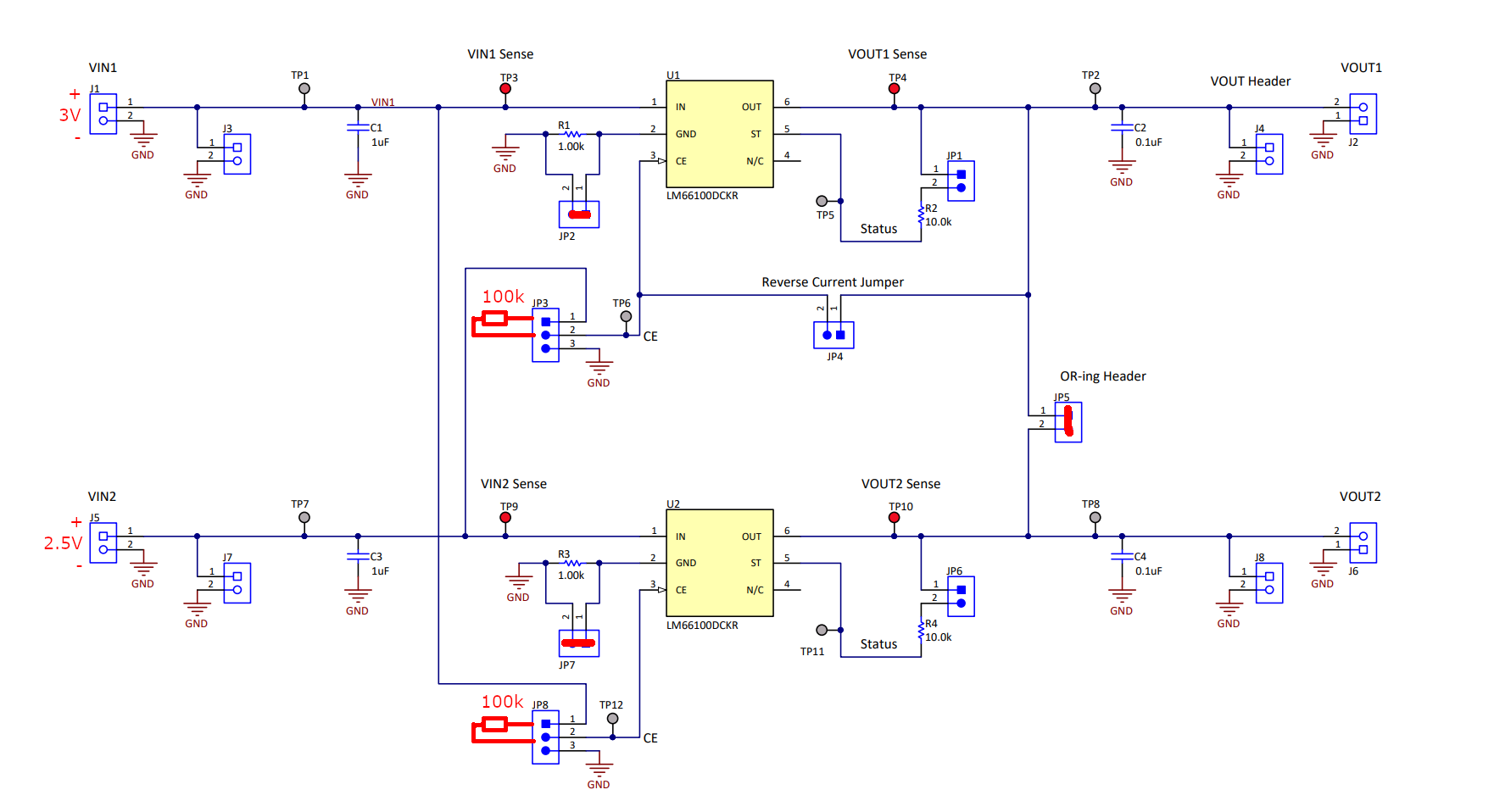

  • Dear Arthur,
    please look at following scheme based on EVM. OR-ing do not work in this configuration. Approx. 3mA flows to VIN2 which is unwanted feature.
    My motivation for this configuration is to limit current when battery is reversed. But additional CE pin resistance disable ORing ability.
    1. Could you please clarify why this happen?
    2. Could you please state maximum CE pin resistance to ensure proper LMV66100 function?
    Radek
  • Hi Radek,
    Why do you have JP2 and JP7 shorted? We use those 1k resistors to mitigate reverse current. Do you still see this issue with those jumpers removed?
