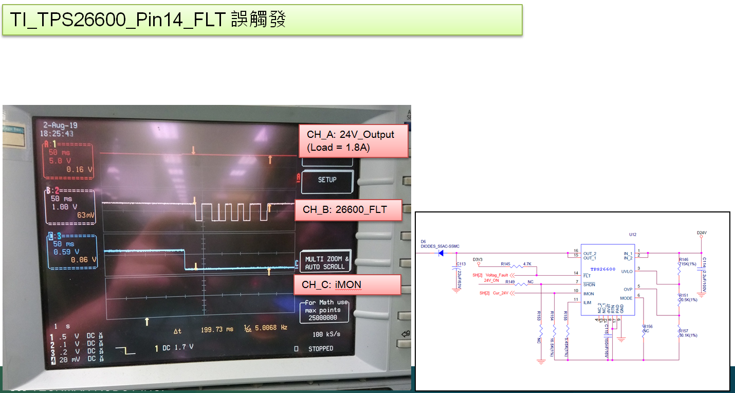

hi sir:
TPS26600 IF_FLT pin abnormal has oscillation. (the oscillation time around 19ms~20ms)
Is there any ripple on the Input voltage? or are there transients on the load?
Can you check if FLT pin goes low with lower output current (~1A) or with higher capacitance (10uF) at the input (C114)?
