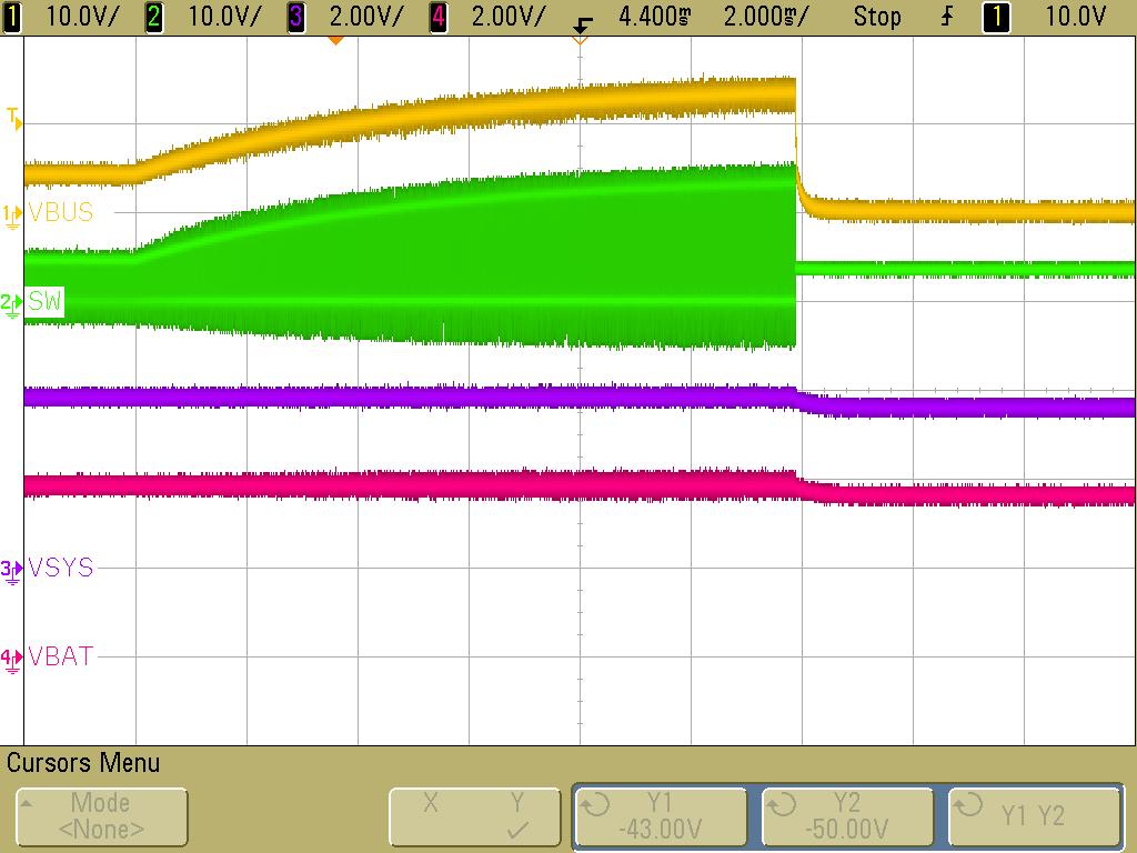

Yes, the battery can still power the system during ACOV.
In the waveform below, I increased VBUS from 5 V up to 15 V in order to enter ACOV. Even though the converter stops switching, VSYS does not fall to zero because it is still powered by VBAT.
