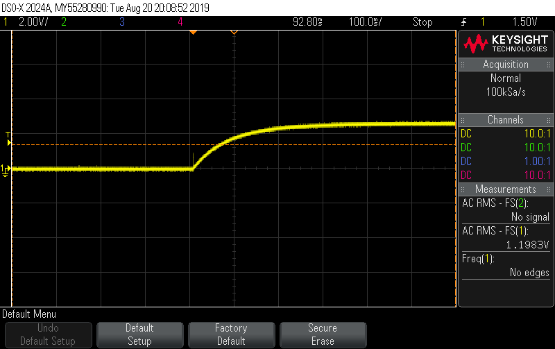

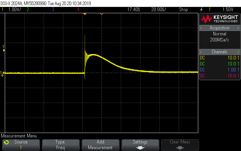

I have a circuit using the LM73605 as Buck converter 10-24V to 5V. It is about the same as the typical Application circuit from the Datasheet.
Cout = 160µ, L = 6.8µ, f = 500k (FORCED PWM), 5ms internal ss
With No load present the converter starts up fine. I can add any load when its runnung.
But with any load it will not start up properly:
4,7µH 47µF LC filter with abput 10mA load = 1.92V output with high ripple (About the Hiccup threshold), same Voltage form on switchnode (not typical Rectangular)
4.7Ohms, 2.35Ohms, 9.4Ohms 0V Output. Just a short spike to 2V then 0V no Hiccup, it doesnt even try. When removing the load long enough it starts up.
I tried: Soft Start time up to 50ms, different switching frequencys (300-900k), Different UVLO Settings. Nothing has helped so far.
Edit:
Output voltages for different loads:
I dont understand why there is a plateau , also switching sems to start at the plateau.
I dont understand why i get only 1.9-2.5V Output
On 10 Ohm load the switching does not even start
500Ohm Load
300Ohm Load
10Ohm Load (Different SCALING)

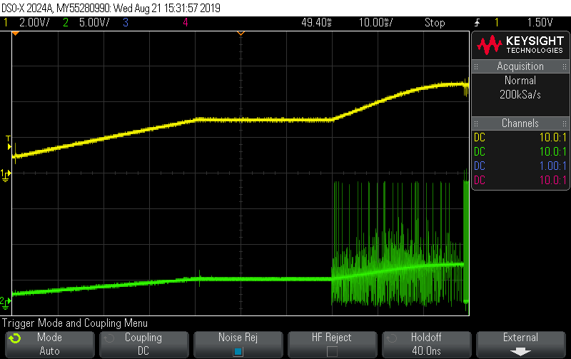

  • My Schematic: (SS cap added with wire, Swapped R303 for 220n cap Tried different RT Values)
    No Load startup Green = Switchnode, Yellow = Output:
    Switchnode during Ramp after plateau
    Steady State
    500 Ohm Startup (Pulses look the same as no Load)

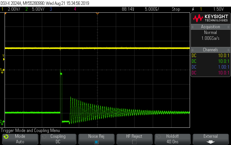

    Output voltage ans switchnode with 10 Ohms
    This pulse is the same as in other startups before the first ramp (the trigger point)
  • Ps i removed one last LC filter dor these.
    Also the steady state of 10Ohms is about 0.1V DC on both nodes nothing else

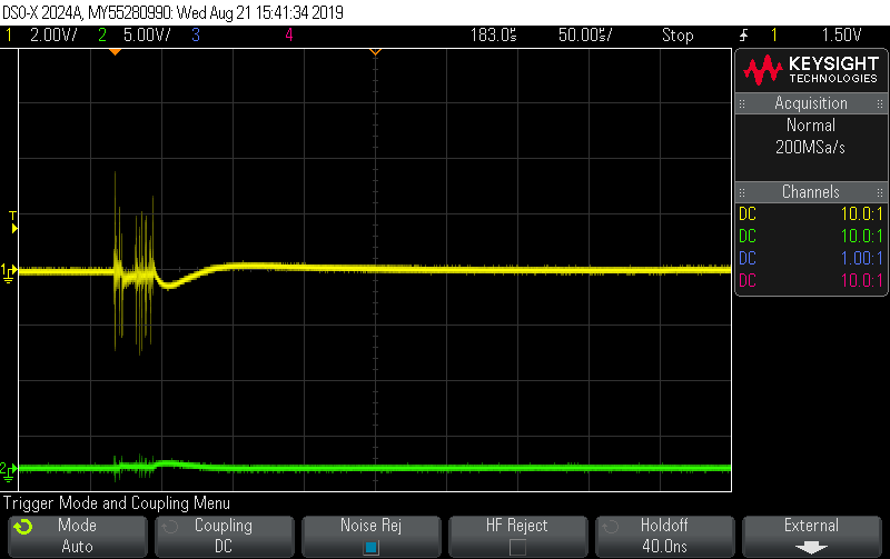

  • Here a 350 Ohm Load , it only outputs about 3 Volt no switching, at 360Ohms switching starts like 500Ohm/NoLoad
  • After building a second version i noticed the Problem.
    Bias and VCC caps where shorted. After removing the short it works fine. It seemd the burden overloaded VCC pin
