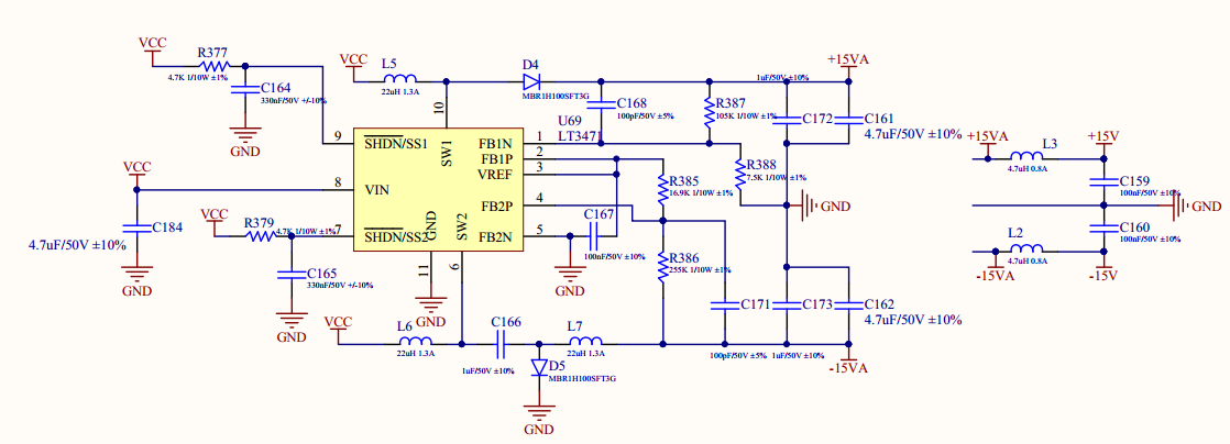

Hello Yue,
Our closest device will be TPS65131. Datasheet/EVM information is available on the web.
Kind Regards,
Liaqat
To my knowledge, TPS65130/131 is the only split rail converter that meets your specification (5Vin, +/-15Vout). I am not finding any other devices under split rail converters.
