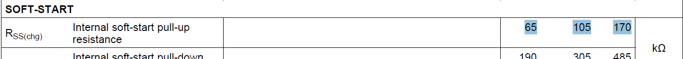

 Q1. In Figure33 on page 25 of TPS40200 datasheet(SLUS659G), which range is correspond to tss calculated with equation (6) on page 17?
      Is the range from about 0.7V to about 1.4V? If the answer is yes, Figure 33 waveform has a little error from it. Do you know the reason of the error?
 Q2. Do you have any equation which can calculate VOUT rising time (the time from voltage rising point to the target voltage stable point)?
      In Figure 33, it seems that the rising time is about 800us.

     I know when VDD exceeds 8V, then Vsst is 8V.
     I want to know  what Vsst voltage is in case of 5V VDD. Is it same voltage as VDD? Is it 5V?

    Yes you are right. VSST is the input voltage up to a maximum of 8 V. If input voltage is less than 8V, then VSST will be equal to input voltage.
    For Q1, the voltage difference is related to the inside of the IC and we need time to give you an accurate answer. For customer's application, I would say the soft start time will have variation. One reason is because of the 105 kOhm resistor. From EC table, the variation is big.
    If you are still interested in the Q1 about 1.4V voltage accuracy, could you send me an email? (neal-zhang@ti.com). I will close the thread of E2E now. Thanks.

     I understood that the soft start time had much variation because of your reply.
     But I still have a few questions about soft start time. So please let me ask you by off line.
