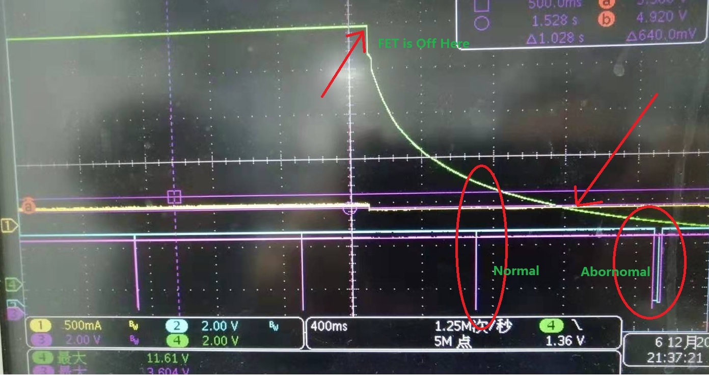

          My application is similar with yours , and I think we are in the same situation. SCL remain low and the communication get stuck and never return normal until remove the battery pack and reset the MCU .
    Have you figured out the root cause and solution ? if Yes ,please help to share your solution ,thanks a lot !
    Here's Update ,I  added the waveform just captured ,Please check if we are encountering the same stuck condition .

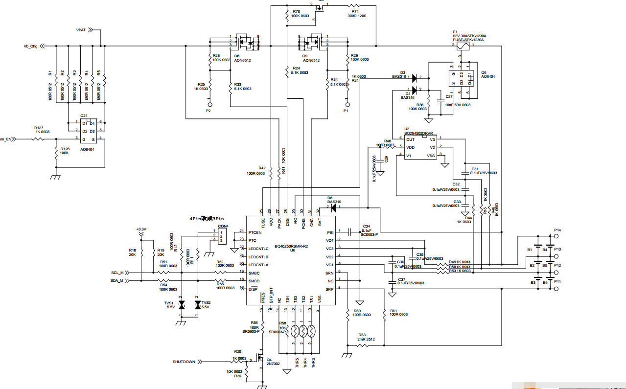

    The waveform shows that the communication get stuck after FET is Off , the communication is scheduled to read BQ40Z50 via a MCU routinely,I still don't find the reason why the FET is off when all the condition is normal . Each time the FET is Off after 8s .After the SMBus get stuck ,I can't read the register and find out which fault is occurred .
     I list the BQ40Z50 Application schematic below the waveform ,please help to check if there is any improper circuit.
    Thanks !
    Benson

  • Hi
        We solve this by calibrate BQ40Z50 correctly and download the the firmware on the other board ,I believe the incorrectly calibrated firmware may trig some OC, OV fault thing.
    Hopefully My solution helps!
    Benson
