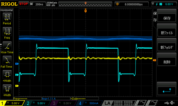

Attached image file is scope shots of OUT, IN, BAT pins of good and bad IC.
Switching waveform of Vout of bad pcb seems to be good, but current is too large.

If not installed, the only other issue I see with the layout is the long ground return path for C103. Can you take a scope shot of OUT, IN, either IN or charger current, zoomed in to see 1-2 pulses at OUT? Please turn off BW limit on the OUT probe channel. I am looking for ringing on either the rising or falling edge of the OUT pulse.

To confirm, the charge current is still accurate at 1A but the input current is higher, resulting in bad efficiency and IC heating? If so, based on your experiments, the IC appears to be damaged.
The undershoot in the scope shots appear to be significant (3V?). Very bad layout can cause that but your layout is not that bad, in my opinion. The IN capacitor needs to have a shorter connection to IN and GND pins. If you want to continue experimenting, you can add a Schottky diode as close to IC OUT and GND pins as possible to clamp the undershoot and see if more units are damaged.

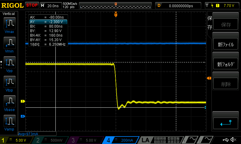

The undershoot of OUT pin in the scopeshot seemed to be larger than it really was, due to bad measuring method.
I improved measuring method and the undershoot became smaller as shown below. However it was -2.3V, exceeding absolute maximum rating : -0.3V~20V.
After adding schottly diode on OUT pin, undershoot became -1.7V, but It's not enough.Do you think improving location of IN capacitor reduce undershoot and risk of overheating?
