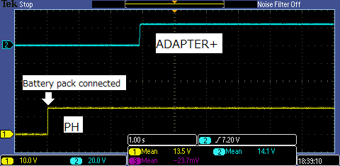

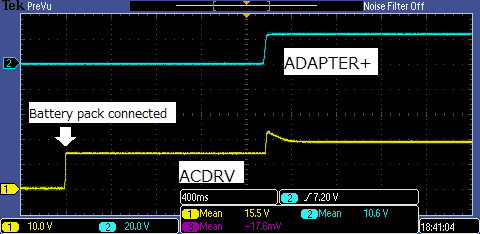

    4. Can you take a waveform of VCC, REGN, PH and ACDRV when adapter is plugged in?
    I took waveforms.
    VCC
    REGN
    PH
    ACDRV

       Looking at your scope capture showing PH:
    • When battery is connected and adapter is not, PH will reflect inserted battery voltage. Once adapter is connected and VCC is present, ACDRV should turn on at VCC - REGN. From your scope captures VCC, and REGN turn on correctly, however once ACDRV = VCC - 6V, this should drive the input reverse blocking FETs, and the VCC voltage should be passed on to PH.
      • Verify voltage at drain of Q6

  • Hi Fuji,
       Apologize for the typo. For VCC voltage, I was looking to make sure that ACDRV fully turns on the ACFETs, which is why I wanted to verify voltage seen at drain of HSFET. If HSFET is off, then yes VCC will not pass on to PH. Please update if there is issue with results from EVM.
