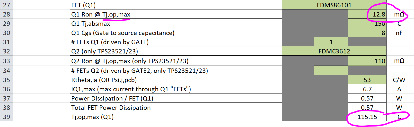

I Request a Design review for TPS23521
Attached Schematic File and Excel file.
could you kindly review it?Datang TPS2352X_Excel_Tool_Web_RevB.xlsx

Hi Liu,
Schematic connections looks good.
In the design sheet, Ron should be entered at operating Tj (F28 cell = 14 mOhm), which pushes operating Tj (F39) to 118C. So, you have to select low Ron and stronger SOA current supported FET such as CSD19536KTT.
A single FET driven by GATE pin is good enough for this design. We can remove V2 FET. Can you update the design sheet and send me for review.

Hi Rakesh
CTM update SCH
Could you kindly review it again?
