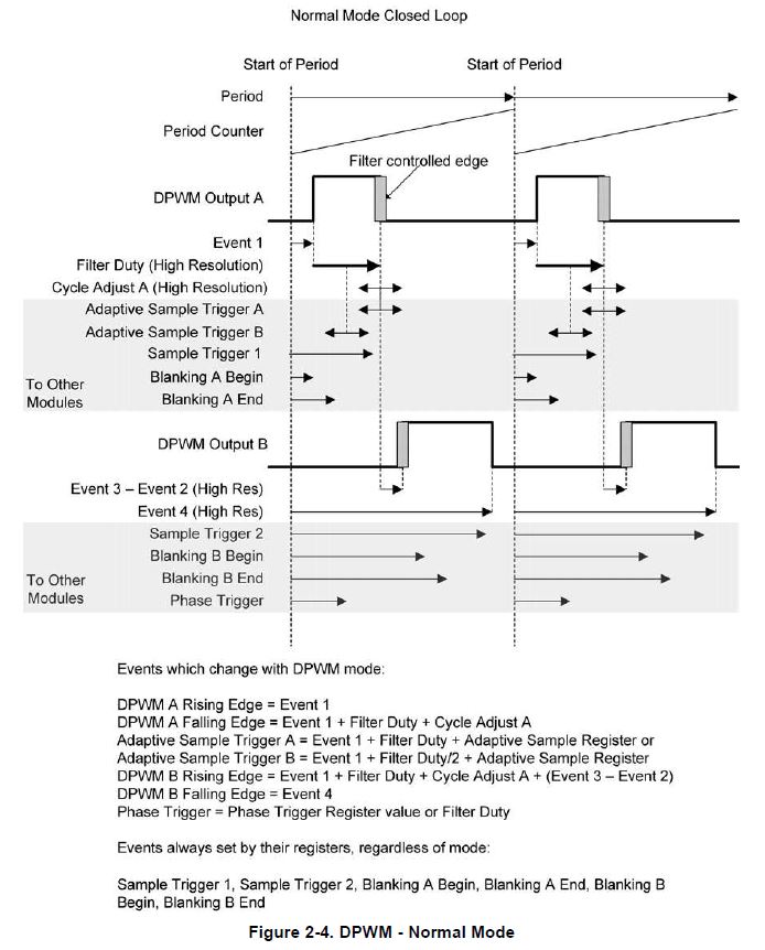

    The figure below is the figure described in the UCD3138 Technical Reference Manual (Literature Number: SNIU028C).
    In this figure, the event relationship is "pwmX_ev1 < pwmX_ev2 < pwmX_ev3 < pwmX_ev4".
    If you set event 4 at the beginning of the period as in your answer, I think the relationship between the edges of PWMA and PWMB is as shown below. Is this perception correct?
    Also, in the sample program described in the first question, pwm0_ev1 and pwm0_ev4 are It will be the same value.
    Doesn't this mean there is no dead time?
  • The first example is also a valid way to use the DPWM and event 4.  It's just not the only one.
    In the second case, I don't know what sample software you are referring to, but if you put the same value in Event1 and Event 4, you will get no dead time.
    If you put a smaller value in Event4, however, you will get dead time.
