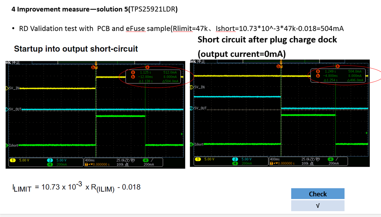

My customer is looking for an E-fuse solution that can shut off with 400mA for 50ms. Please share your suggestions, thanks.

  • Hi Praveen,
    Customer need to turn off with 400mA within 50ms for an over current event. They used TPS25921 before, but after test they found it took >1s to turn off the e-fuse, which can't meet the demand. Please share your suggestions, thanks.

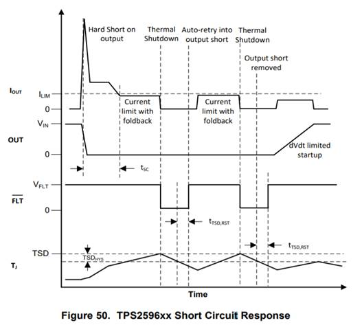

  • Hi Minqi Zhao,
    It is important for you to understand how our devices react to a short circuit at the output.
    • When a short circuit is applied at the output, the current flowing from IN to OUT increases rapidly. If the current exceeds 1.5 x ILIM, the device engages a fast current clamping circuit to regulate down the current faster than the nominal overcurrent response time (tLIM). The device does not completely turn off the power FET to ensure uninterrupted power in the event of transient overcurrents or supply transients. Once the device is in current limit mode, it will turn off only when the device junction temperature reaches thermal shutdown threshold (TSD).
    • The time taken for the device to reach thermal shutdown depends on various parameters like input voltage, current limit setting, RQJA and ambient temperature.
    If all the parameters ,(Vin, Current limit setting , RQJA and ambient temperature) are low the device will take more time to erach TSD and turn off. Similarly, for the device to turn off faster these parameters need to be higher.
    All our efuse devices have similar behaviour to a short circuit at the output.
    There is one device  TPS255x which turns off after a fixed 7.5ms time duration from entering current limit mode after a short circuit event. You can check  if this device meets their requirements.
